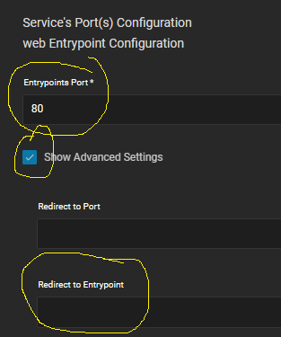

You can just set it to off!
if you use TrueNAS, go to your traefik app and hit "edit", on the field where you enter the default webport (80) there is an checkbox for "advanced settings" behind this checkbox is an option that will redirect default 80 to websecure, just remove the word websecure and traefik is working as exsppected.

Thank you both @iptoux and @guiguijke
I had to do both of what you suggested:
1. put 'web' instead of 'websecure' in your app settings
2. remove "Redirect to entrypoint"
Unfortunately some of the truechart apps expect https, which is hardcoded
