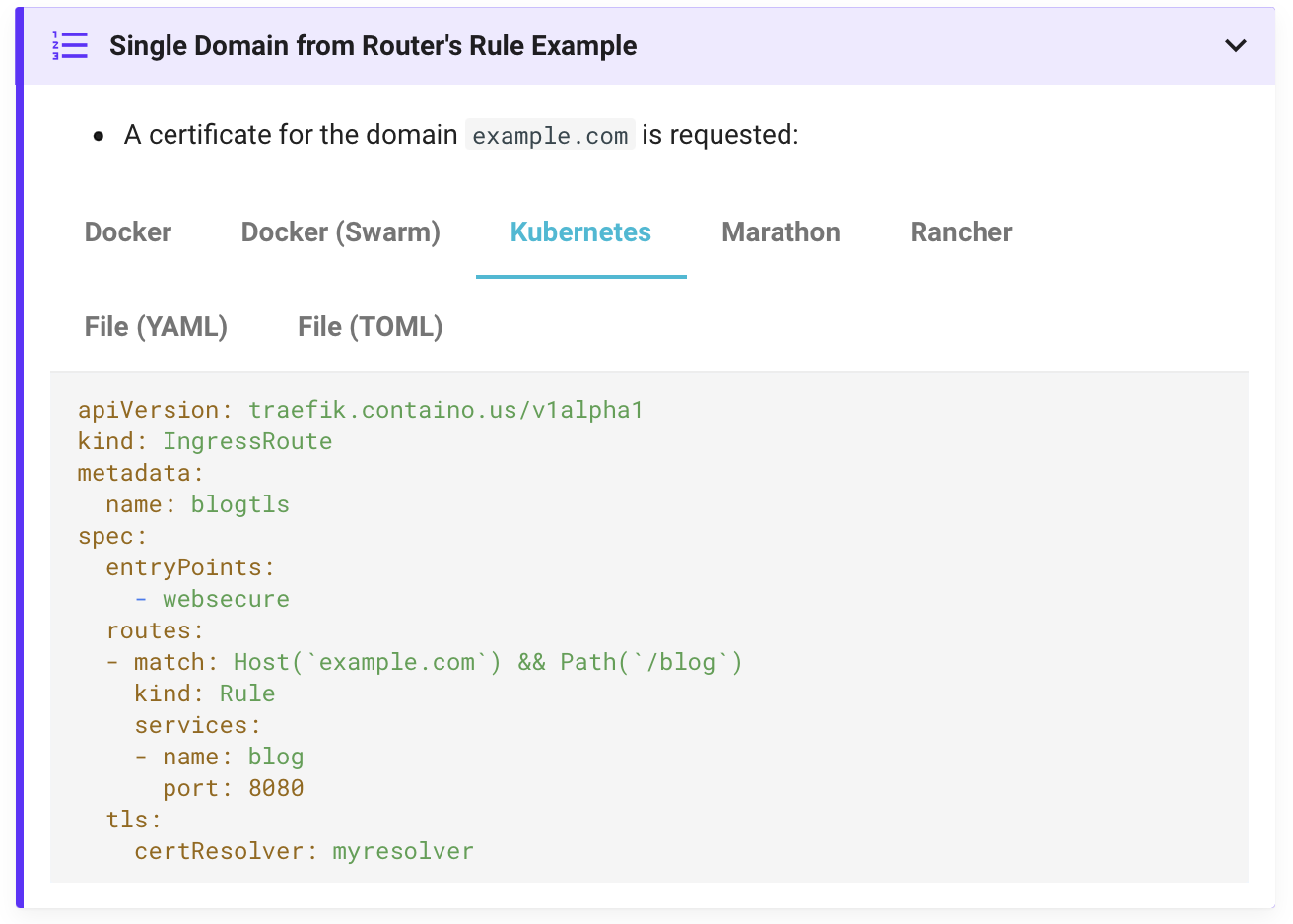

I found this guide on traefik official website (https://doc.traefik.io/traefik/https/acme/) and after some wild guessing I imagine I need to do this:

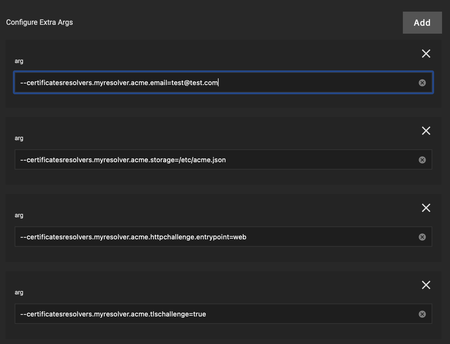

- in the traefik app>setting> extra args I added this:
(I created in the traefik container a acme.json file and disabled read only for the system)

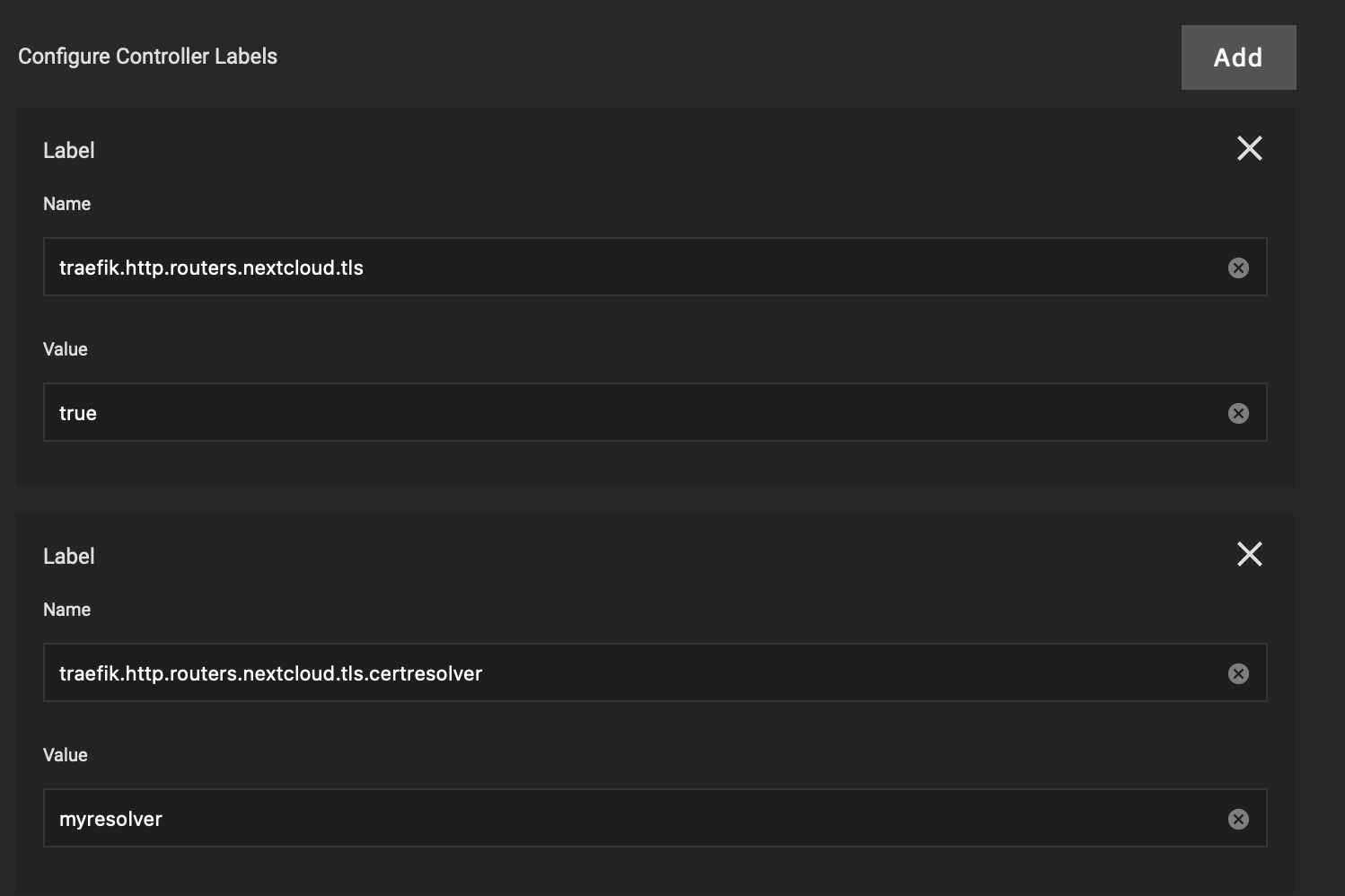

- the nextcloud app>settings>label I added this:
I took the liberty to assume that the label
- traefik.http.routers.blog.rule=Host(`example.com`) && Path(`/blog`)
was already automatically generated so I did not add it.
Things I think I'm doing wrong:
- the name of the routers in the nextcloud app, there's always an alphanumeric sequence afterwards, it changes after every reboot. so that may be an error
- the extra args formatting

You are NOT running docker.
You're running kubernetes, docker labels are not the same as kubernetes labels.
Generally speaking you cannot use "the docker way" with Traefik on TrueNAS SCALE.
"As you probably just guessed I can't use the very easy guide from truecharts. that would be too easy."
You could at least try using our App and not use the guide. There is more going into the Traefik side than "just" loading the container, we pre-configure a lot of things and it's running as "Traefik ingress provider" not "docker-traefik".
While you could, in theory, run Traefik ingress provider using Launch Docker for the most part, there are issues that you cannot resolve using Launch Docker and a number of serieus security flaws when doing this.
Please for the sake of the security of your data: Don't try to DIY Traefik using Launch Docker.

So am I on the correct path with the extra args settings but WAY out with the labels? how do I get this:
to fit into the app settings?
or even better: is it even possible to do what I'm trying to do?

You seem to be thinking that Launch Docker is somehow a complete solution. It's not.
It's a short-cut solution to run basic Docker-Containers on kubernetes.
There is a reason organisations like us, k8s-at-home and bitnami, write Helm Charts. If it all fitted in a small standardised GUI we wouldn't even exist. For many Applications a good solid deployment takes more than Launch-Docker is going to offer.
But definately it's not made for intricate kubernetes system additions like: IngressProviders, CRD's, CNI's etc.
Simply put:
You should not even be trying anything in this direction without a above-average understanding of Native kubernetes and Helm, without complications from trying to do things on SCALE.
We'll leave it at this, as you litterally would have to duplicate the work done in one of them available Helm Charts or SCALE Apps, like ours of the official Helm chart. We do not have the manpower to walk you through redoing one of our most intricate projects.
We're not saying this to discourage you from messing around with the system a bit, but trying to take on something that is this complicated, without even a basic understanding what you're dealing with on a high level, is just going to only be confusing yourself and others.
Simply put: At this time you're not even able to ask the right questions, let alone get the right answers.
Just be like any good devops engineer and work from what already exists. There is a reason even we and other big Helm Chart/SCALE App builders do this. It's not a show of a lack of skill, it's just that some things are rather hard to get right.
To answer your questions:
No you cannot completely deploy Traefik as an ingress provider including CRD's etc using launch docker. As it's (both Launch Docker and Traefik) not meant to be sued that way.

Just to summarize for folks like me who found this thread trying to do what OP is trying to do:
Official TrueCharts automatic SSL is only possible if your DNS is managed by CloudFlare or Route53. The quick start guide implies you have other options and those two are just the easiest, but practically you don't. Your only alternative is to manually manage certificates, or host your apps elsewhere.
The reason is that TrueCharts configures Traefik to use a TrueNAS certificate. TrueNAS only supports certificates via DNS challenges via those two providers.
Yes Traefik itself can manage certificates itself with options similar to what OP is trying. But it's impossible to actually pass those options to the Traefik binary. The options OP is setting do not get passed to the binary (I can't find any docs that say where they do get passed).
The arguments to the traefik binary get constructed here. There is no mechanism to add any arbitrary args, you can only use what the web form will let you.
I don't see a reason why it couldn't be made to work, but the truecharts folks would have to add support for those switches.

Just for fun I hacked the chart to add the following command lines that ask Traefik to use a TLS Challenge against Let's Encrypt's staging servers:
--certificatesresolvers.le.acme.tlsChallenge=true
--certificatesresolvers.le.acme.storage=/shared/acme.json
--certificatesresolvers.le.acme.email=test@gmail.com
--certificatesresolvers.le.acme.caserver=https://acme-staging-v02.api.letsencrypt.org/directory
--entrypoints.websecure.http.tls.certResolver=le
SSL then works great on every endpoint.
That's all it seems to take to have automatic SSL for all your public TrueCharts apps. A text field for the email, a dropdown to choose staging/prod, and mounting a storage location for acme.json. That's hardly any config options to add a hugely important feature.
Can someone explain if there's a downside to this? Besides the afore-mentioned HA concerns.
