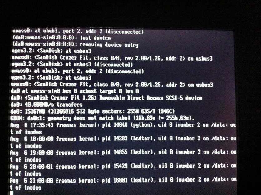

Here is the problem. I am able to install FreeNas fine on the flash drive and the server boots up correctly. I am able to log into the web gui and perform various functions perfectly. I was able to set up the hard drive, create users, install a file system, NIC, etc. Basically it seems like FreeNas is functioning perfectly. Inevitably after I log out of the web gui, some time in the future the server will go off line and I am no longer able to access it via the gui. When I look at the server monitor there are a bunch of lines in the screen that I don't understand (please look at the attached photo). It looks like the server is disconnecting the USB drive. I'm not sure what to do about this. I have tried to do some things on my own but with no luck. If I restart the server before I go to bed it will be down by morning. Any help would be greatly appreciated.

I would try a different flash drive, sometimes they're just flaky, this looks like it could be one of those.

Thanks for the advice. I have tried a couple of different USB drives so far, which is why I am beginning to think it might be a hardware issue with me or something in the bios settings. I will try another USB drive tonight, I have an 8GB I can use. Got up this morning and the same thing had happened. I was unable to access the server via the GUI. One interesting thing to me is that it is still sending me emails every 30 minutes. Each email is an error message because it can't do something it needs to do but that must me that it is not completely hung right?

Once FreeNAS boots from the USB, it runs completely from RAM, which is why you're getting the emails, but it does write some reporting data to /data (on usb) and since your USB has disconnected that can't happen.
Only guess I can think of is a heat related hardware problem. You could try opening the case and putting some external fan blowing inside and see if the problem goes away. Have you tried another USB port?
