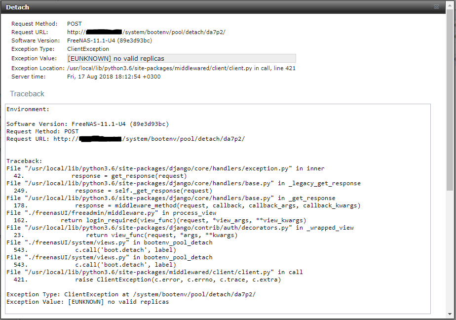

So, the problem is that freenas is installed in single USB memory, which now gives errors and status have turned to degraded. After that I mirrored boot drive, which appears to be successful. Desilvering takes about 40 minutes to complete. After that I have tried to remove old, degraded drive. But all I get is following error shown on attachment.
My last attempt and hope to fix everything, was to reinstall freenas to new USB drive. That succeed, and I were able to import old settings. But, importing the encrypted volume failed. I read about this problem, only to find out that most likely this is a know bug where you cannot do this operation thru GUI (and zpool status gave nothing on command-line). After that I decided to change original USB drive to server. Now everything runs just fine again, except boot disk is degraded and I still cant detach this drive. But I cant live like this for ever, since if drive fails and I cannot import the file system, I have bunch of files and photos worth of nothing. My backup server is under work, but have had problems with the motherboard KVM.

Maybe both of them suffer some errors? Do you have a third one to try making a 3-way mirror to give a test?
(might end with 3-way mirror without possibility to detach any if the problem is more serious :( )
EDIT: Anyway I am rather a noob and
can't understand how come a faulty drive managed to mirror itself to a second one... It copied the errors to the mirror?

[MiddlewareError: [EFAULT] 3-way mirror not supported yet]
So, that didn't help much... But at least, that been tried now.

I'm pretty sure that silvering doesn't complete all the way, and that is why i get error "no valid replicas". So as you suspected, faulty drive cant manage replicate itself.
