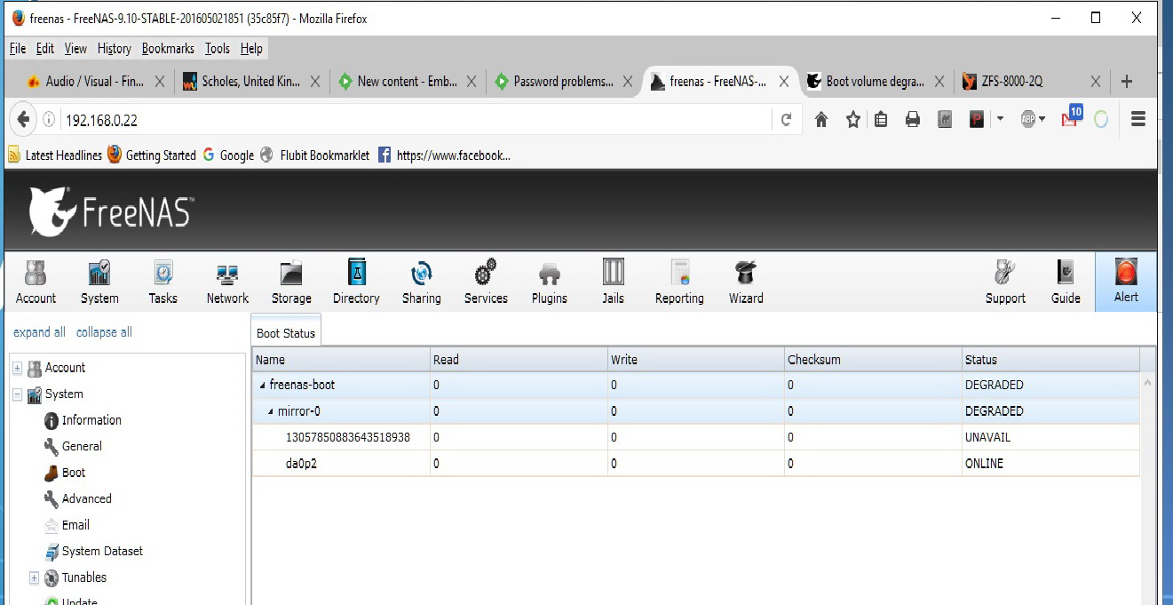

I got this email from my freenas box regarding the problem:
Checking status of zfs pools:
NAME SIZE ALLOC FREE EXPANDSZ FRAG CAP DEDUP HEALTH ALTROOT
Backup_Data 928G 683G 245G - 18% 73% 1.00x ONLINE /mnt
CCTV 928G 17.2G 911G - 7% 1% 1.00x ONLINE /mnt
WinShare 7.25T 1.81T 5.44T - 2% 24% 1.00x ONLINE /mnt
freenas-boot 7.19G 3.45G 3.74G - - 47% 1.00x DEGRADED -
pool: freenas-boot
state: DEGRADED
status: One or more devices could not be opened. Sufficient replicas exist for
the pool to continue functioning in a degraded state.
action: Attach the missing device and online it using 'zpool online'.
see: http://illumos.org/msg/ZFS-8000-2Q
scan: scrub repaired 0 in 0h4m with 0 errors on Wed May 18 17:49:37 2016
config:
NAME STATE READ WRITE CKSUM
freenas-boot DEGRADED 0 0 0
mirror-0 DEGRADED 0 0 0
gptid/3f850095-85e5-11e4-8708-001f16a89eef ONLINE 0 0 0
13057850883643518938 UNAVAIL 0 0 0 was /dev/gptid/ba4ca184-875e-11e4-a252-0cc47a0c1eef
errors: No known data errors
This is a screenshot of the boot status.

So from my screenshot, does that give any indication of which driver is which, as it doesn't make it clear enough for me.
Robert Trevellyan
Pony Wrangler
May 16, 2014
3,778
No, the screenshot doesn't help, but you might be able to figure it out by matching device names with dmesg output. In other words, the one that isn't da0 is the one you need to replace.

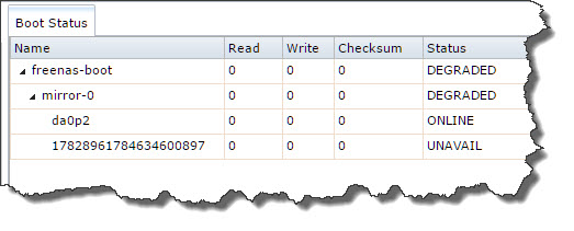

I just had this happen to me today (first time). Is there a way to fix the USB stick or is it a physical problem? What is it that actually goes wrong/bad with this stick? Thanks.
tvsjr
Aug 29, 2015
959
It's usually a physical problem. The sticks (and any flash memory, including high-dollar data center SSDs) have a certain endurance - each cell can only be rewritten a certain number of times. USB sticks aren't known for having phenomenal endurance (nor quality control)... over time, they tend to fail.
