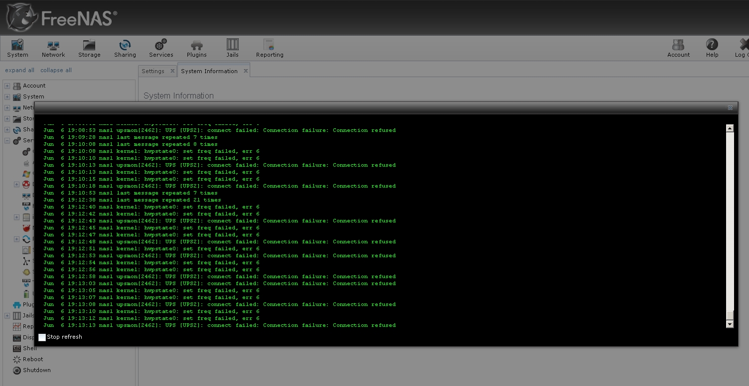

I have just upgraded to 9.2.1.5-x64 eager to see if my problem with the UPS was solved.
Unfortunately it was not and since I couldn't find another post on this subject, here's my bug report.
I have configured FreeNAS to connect to an APC Smart-UPS RT 2000 RM XL equipped with a AP9630 Network Management Card 2.
The problem is the UPS service does not start properly upon boot. I keep getting the message:
upsmon: connect failed (see attached picture). The web interface says the service is running but there's no communication with the UPS.
Now, if the service was not configured correctly, things would not work flawlessly after I restart the service. But they do!
I have done a "ps ax" after boot (see attached ps-1.txt) and again after I restarted the UPS service from the web interface (see ps-2.txt). There seems to be a process that was not running after boot:
4374 ??  Ss    0:00.01 /usr/local/libexec/nut/snmp-ups -a UPS2

hey I'm curious if you ever found a resolution to this... I'm using snmp-ups for a Smart UPS SUA3000XL with an AP9617 and when I trigger a shutdown I get "Communications with UPS APC lost" before it gets a SHUTDOWN signal from the UPS... polling at 5s. And I've encountered your issue as well... UPS service is running on boot, "connection refused" and if I turn off and on the service from FreeNAS Web GUI it starts working... (on 9.2.1.7 here)
