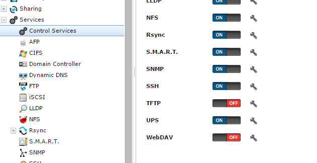

Limitedheadroom
Aug 21, 2015
34
Thanks,
I get nothing.
[root@ChassNAS] ~# ps -auxg | grep ups
[root@ChassNAS] ~#
DrKK
FreeNAS Generalissimo
Oct 15, 2013
3,630
OK, you're getting nothing, *AND*, you are, or are not, getting emails from the UPS service?
Limitedheadroom
Aug 21, 2015
34
I was getting emails from the service when it was on, until I disabled that option, it was too many.
I just tried the same command with the service switched on and still get nothing.
