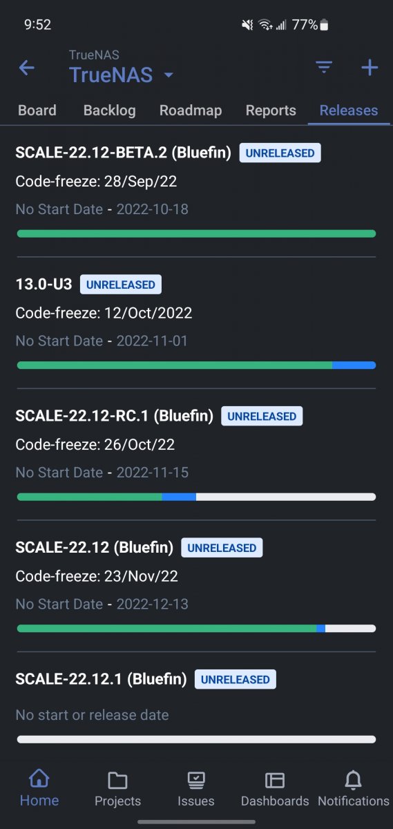

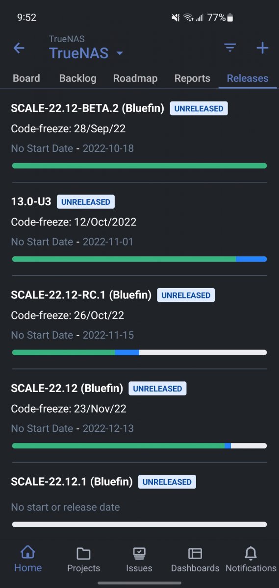

I believe it is if you're on sign into Jira and linking it to the truenas board you can see the scheduled release dates.
I hope this helps.
you can check this link if you just want to see what the current stat of all the versions are.
