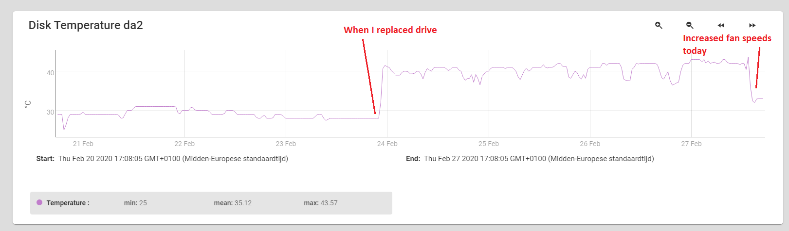

Last weekend I upgraded my storage pool from 4x 4TB to 4x 8TB. Both the 4TB and 8TB are WD Red drives. After I was done with upgrading the storage pool I noticed the temperatures of my new disks were significantly higher compared to my old drives. Aside from swapping the drives one-by-one I haven't changed anything in my system. The drives are in the same location. Here is a graph of the worst drive:
  1. Has anyone else experienced this with the 8TB WD Red drives?
  2. Was this to be expected?
  3. Was this an after effect of the re-silvering process perhaps, and the drives just never managed to return to normal operating temperature?
I managed to increase the fan speeds of the intake and exhaust fans of the compartment where the drives are located. Temperatures are back in the normal range now.

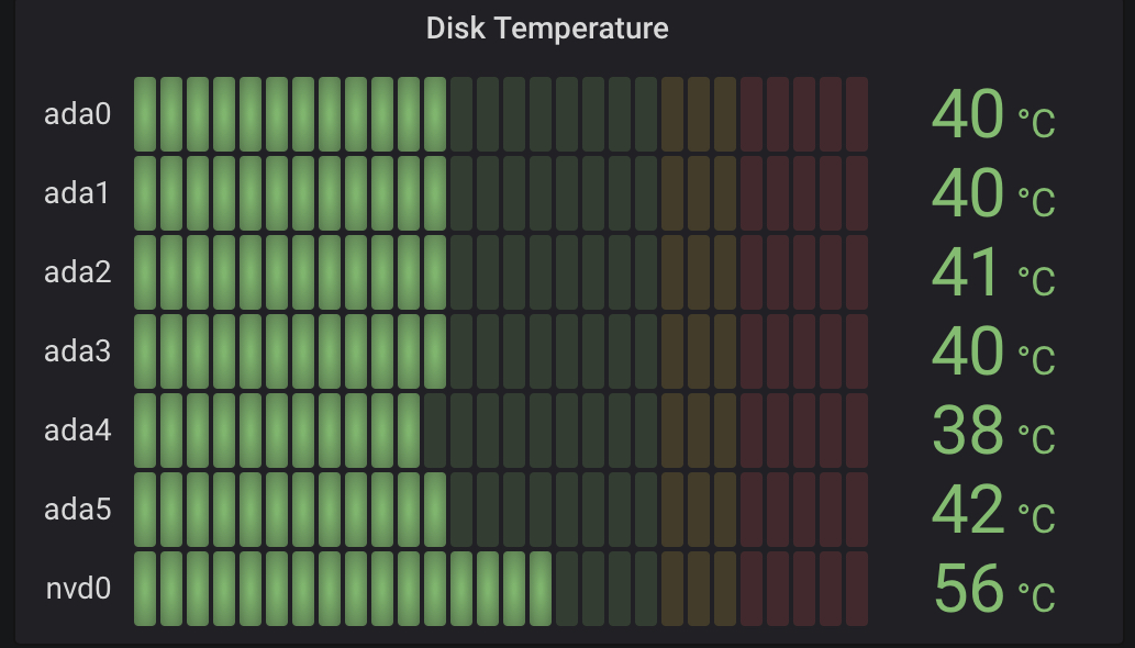

Patrick M. Hausen
Nov 25, 2013
7,776
But 40-ish Celsius is still cozy! Look up the specs of your drives and check the operating temperature. The should be certified for 0 to 65 or in that order of magnitude.
Just relax ... ;)
Patrick
P.S. These are mine:
ada0-3 3.5" spinning, ada4-5 2.5" SSD

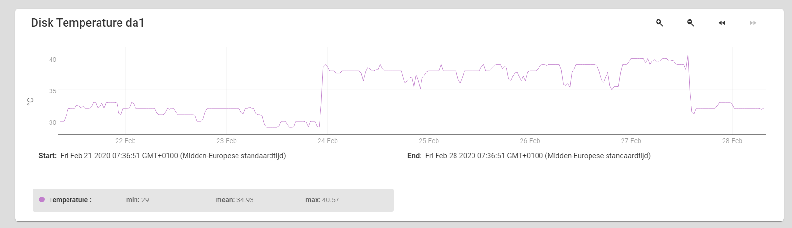

Just took another screenshot. You can clearly see the rise in temps. So the period before 24 Feb was my old 4TB drive and since 24 Feb is the 8TB drive. Also you can see when I increased the RPM of my fans yesterday.
