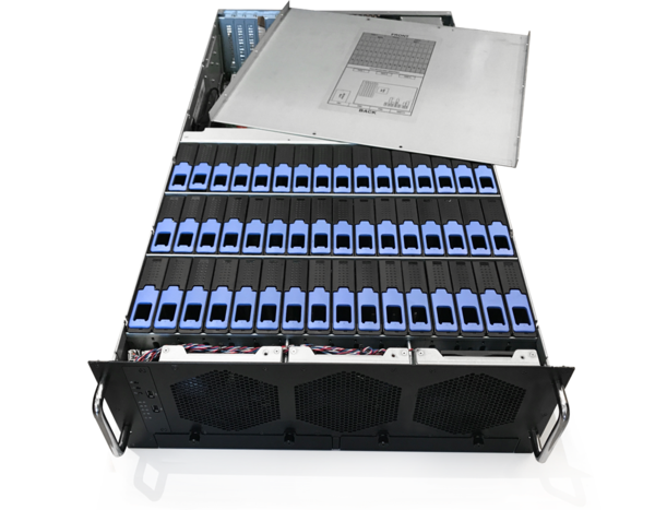

I have a 48 bay server like this as my primary FreeNAS system at home:
1556653077533.png click to enlarge...
The drives on the front row, right behind the inlet fans stay between 28°C and 31°C. The next row of drives is a couple of degrees hotter and the back row of drives is usually around 36°C to as much as 38°C. Most of the drives (21 of 32, if I recall correctly) are Seagate Desktop drives (ST4000DM000) like this:
1556653445263.png click to enlarge...
These 5900 RPM drives run cooler that the three Seagate Constellation drives that are 7200 RPM drives. They are in the same pool with the Desktop dives. The Constellation drives look a little different, so you can tell the design is different, but I think the big deciding factor on the heat is the RPM. I have the Constellation drives mounted in the front row to help keep them cool, where the other drives are in the low 30s, the Constellation drives are in the high 30s but not usually over 40°C, still it is almost ten degrees difference, while mounted in the same row of the same chassis, with the same air flow, same room, same capacity, same drive vendor... I only see one difference to justify the temperature difference, the RPM.

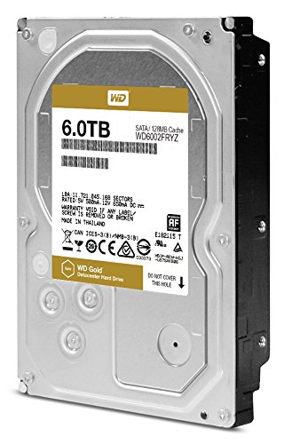

Also in this chassis, I have a pool made up of Western Digital Gold 6TB drives, like this:
1556654063643.png click to enlarge...
Those are also 7200 RPM drives and they are the hottest of all. They are all running between 38°C and 42°C very consistently ten degrees hotter than the slower spinning Seagate Desktop drives. I don't have a fancy IR camera to look at but I do monitor my system closely and I have been doing so since the first system I built back in 2011 with used drives I bought from eBay. I have (over the years) had drives from every vendor, Samsung Spinpoint for example, in every size from 1TB up and this is just speaking of the ones I have at home.

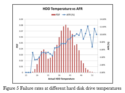

And another paper by Microsoft and University of Virginia which is also a good read
https://cheetah.cs.virginia.edu/~gurumurthi/papers/acmtos13.pdf
Authors: SRIRAM SANKAR, Microsoft Corporation MARK SHAW, Microsoft Corporation KUSHAGRA VAID, Microsoft Corporation SUDHANVA GURUMURTHI, University of Virginia
Here is a quote from the paper you cited:
Yang et al [1999] establishes that a 25 C delta in temperature derates the MTTF by a factor of 2 in their study on Quantum hard disk drives. Cole et al [2000] from Seagate, present thermal de-rating models showing that MTTF could degrade by close to 50% when going from operating temperatures of 30C to 42C. Our results agree with the observations made by Cole. Our measured failure rates also exceed the AFR rates that manufacturers mention in their datasheets
I guess you didn't actually read it because what that says is that going from 30C to 42C increases failure rate by 50%
