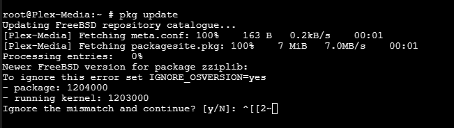

Hello,
I have recently upgraded my TrueNAS Core server and then proceeded to upgrade my jail. The problem is that my jail is upgrading to 13.1-RELEASE-p9 (from 12.3-RELEASE-p5) while my TrueNAS system has the version 13.1-RELEASE-p7. How can I make my jail upgrade only to 13.1-RELEASE-p7 to avoid mismatch errors.

In that case, then something else is amiss. I get this when doing pkg update:
Any idea how to fix it?

FreeBSD 13.1 went EOL last month.
You should upgrade your jails to 13.2 using the iocage "fetch" and "upgrade" tools.

What mismatch? TrueNAS CORE is on FreeBSD 13-STABLE. Your jails will be on FreeBSD 13.2. No mismatch.
Previously, when I was on version 13.1, I received a mismatch error between my kernel and package(when doing pkg update) even though the jail had a patch version higher than my host. However, after upgrading to 13.2, the message no longer appears. I'm unsure why it doesn't show up anymore, but at least the issue is resolved :)

With FreeBSD 13.1 finally EOL the quarterly packages switched to 13.2 for the quarterly branch at start of July. That's why you need to upgrade your jails to 13.2. 13.1 is not supported any more by packages.
You are not experiencing a mismatch of TrueNAS host and jail. It's a mismatch of the jail's FreeBSD version and the package repository. Happens for every version switch.
