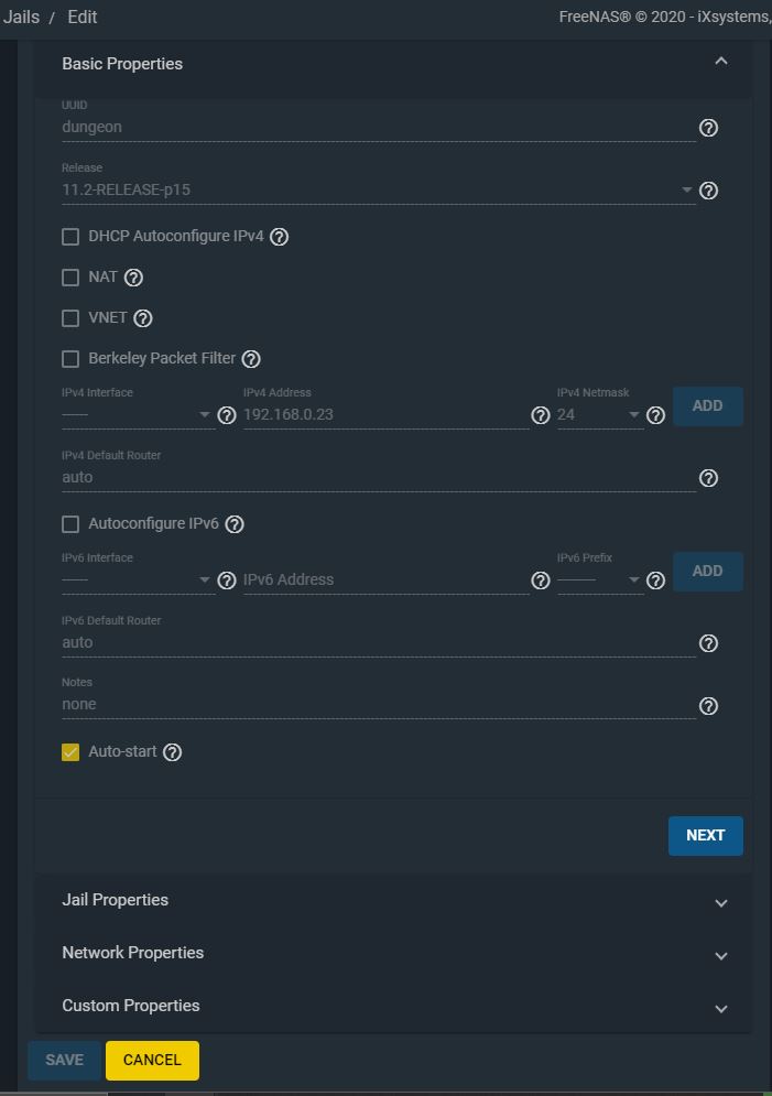

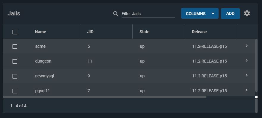

anyways, in the 'dungeon' jail (jid 11), there's no 'upgrade' in the path, is this something I need to install?

Try using iocage list. That way you will get the "real" jail name.

no, I deleted my last warden jail before I upgraded from 11.2 to 11.3
