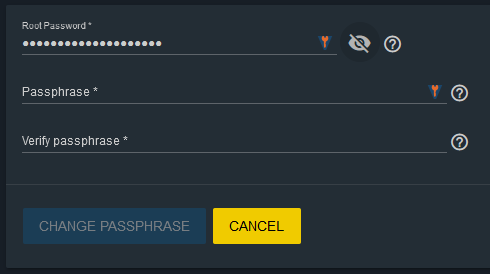

Sitting behind my FreeNAS box right now it also indeed looks like removing the passphrase is not an option. Although geli appears to support it: https://serverfault.com/questions/319792/geli-eli-at-freebsd-changing-passphrase
I'm not sure if I feel brave enough to mess with this though.
