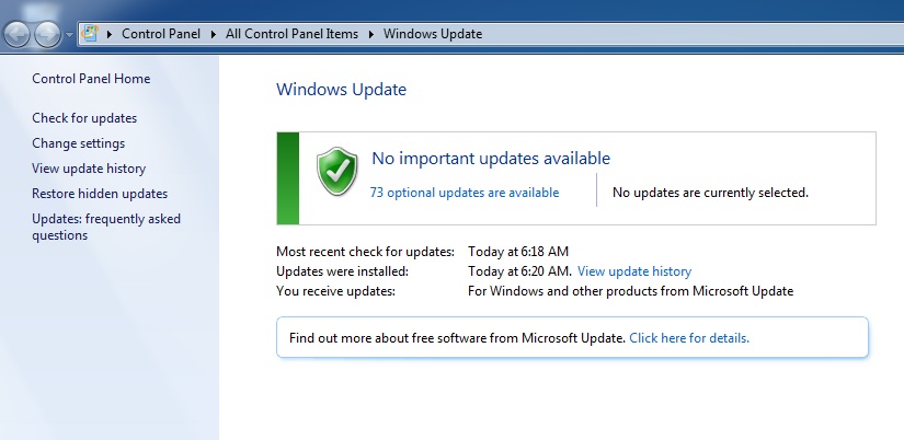

BigDave
FreeNAS Enthusiast
Oct 6, 2013
2,479
100% total success, check it out.
Download "WSUS offline" and build an update package. I have experienced the issue myself on both Win 7 and Vista. This resolved the issue on both OS' and after getting over the hurdle subsequent updates went fine.
A lot of users have run into this issue.
This post was awesome and turned out to be the solution to my woes.
A huge thanks to @gpsguy
Now where to send that monetary thank you?
PM me your PayPal address?
