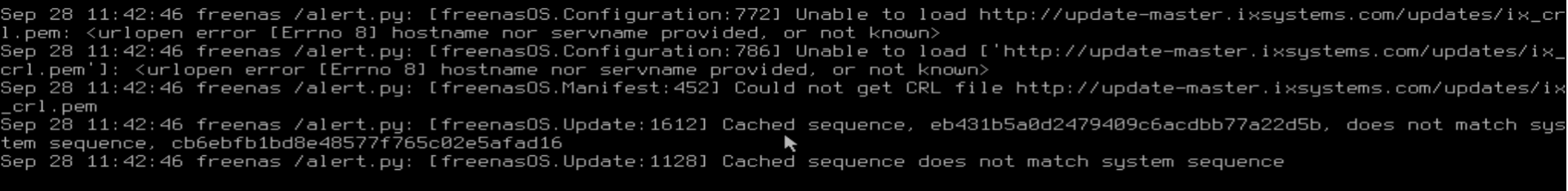

I tried to update my FreeNAS 11.0-U3 to U4 this morning but I can't boot with U4. After some strange grub errors I managed to boot back the old U3 install and all seems to work again. When I try to boot U4 i get the errors you see in the screenshot. Does anyone else have this problem?
Pressing any key doesn't do anything, all I can do is reset.

Interesting error. Please create a bug report at bugs.freenas.org and post the issue number here.

I managed to work around the problem. Somehow grub doesn't like the AMD SP5100 s-ata controller. I moved the boot ssd to a different controller (the lsi, used for storage) and it booted without any problems. So the AMD SP5100 is the problem here. Funny thing tough is that if the system is booting, and running, you can use the controller without issues. ( I used it for storage in Corral and used a usb stick for boot previously ).
