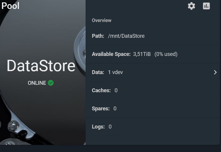

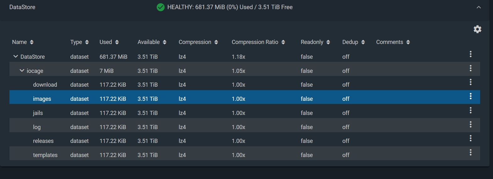

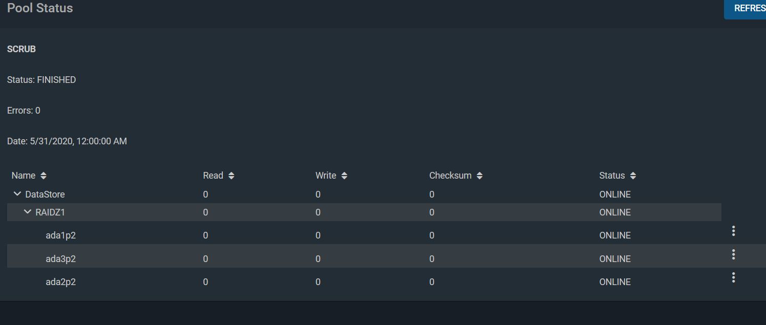

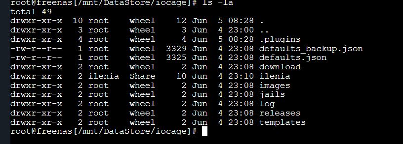

Sorry, I reviewed the situation ... it didn't happen for the system update (it didn't update), yesterday I tried to reinstall the plugin qborrorrente (I was never able to log in, authentication error) and it gave me the error "Error: torrent had a failure Exception: RuntimeError Message: Stopped torrent due to VNET failure Partial plugin destroyed". I gave the shell command "iocage clean -a". I restarted the nas, I checked that the data was present and so far everything is ok (I also tried to copy into the files). At this point I tried to reinstall the plugin and I realized that all the plugins had been deleted. I tried to install the qbittorrent plugin again and asked me which datastore to install it on and I chose the data one. The plugin did not install ... and shortly thereafter I realized that my network shares gave access error. At this point I realized that the whole datastore was empty, and the folders present had just been created. As a fool I hadn't enabled snapshots. I have photos of a life inside, especially those of children. Can you help me? Thanks
Jun 3, 2014
21
some photos

I'm sorry, but there's nothing that can be done. You deleted everything when you ran iocage clean -a, and because you structured your data completely within the iocage dataset, iocage cleaned up everything within. There are no snapshots, so no recovery points.
Samuel Tai
Apr 24, 2020
5,399
If you had structured your data in a separate dataset outside the iocage dataset, and used jail mounts to make it available to plugins, then this wouldn't have happened.
