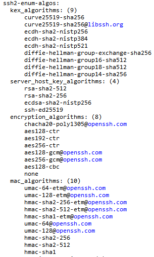

I've been looking for a long time to find out what settings (cipher,...) are actually taken into account by ssh on Truenas. I didn't find a command that works directly on Truenas, if you have one, I'm interested.
On the other hand, it is possible to do it from the client by installing the NMAP application (a scanner which allows to provide information about the ports, services, ... of the network)
I found this command on the internet :
nmap -sV -p T:22 --script ssh2-enum-algos <server_ip_>
(Attention the ssh port must be the default port [22])
I think the software is talking to the service in question and asking it what it is able to do.

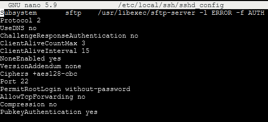

I have performed some tests:
TEST 1:
SSH Service > advanced options > Weak Ciphers
  • case "None" : check
  • case "AES-128-CBC" : check
  • auxiliary parameter : none

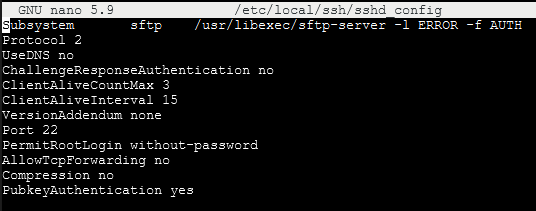

Scan NMAP application (see "encryption _algorithms" section) and sshd_config file :
TEST 2:
  • case "None" : uncheck
  • case "AES-128-CBC" : uncheck
These two tests show first of all that:
1]"none" is indeed the "NoneEnabled" parameter
2] the encryption algorithms used are :
chacha20-poly1305@openssh.com
aes128-ctr
aes192-ctr
aes256-ctr
aes128-gcm@openssh.com
aes256-gcm@openssh.com

we can see that the algorithms : 3des-cbc, aes128-cbc, aes192-cbc, and aes256-cbc are not in the algorithms brought out by nmap

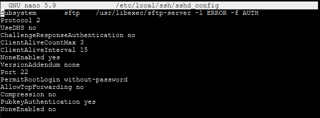

TEST 3 :
  • case "AES-128-CBC" : unheck
  • auxiliary parameter : NoneEnabled no
This last test is very interesting because I checked the "none" option, and I added the reverse parameter "NoneEnabled no" in the auxiliary parameters in ssh service parameter of Truenas.
In the sshd_config file, as you can see in the picture, I have two lines added:
  • NoneEnabled yes
  • NoneEnabled no
When we scan with NMAP, we see that "none" is present, so it is the "NoneEnabled yes" parameter that is systematically recognized.
