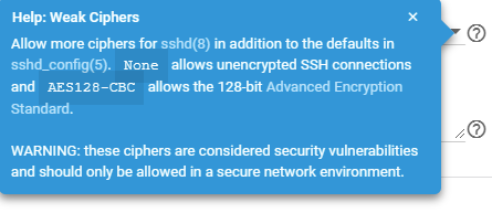

The help button is also not of much help, because it only says "Allow more ciphers for sshd(8)..."

Click on the tool-tip question mark in the circle for the answer:
Basically, None allows fallback all the way to unencrypted sessions. AES128-CBC allows fallback only to AES128-CBC as the weakest cipher.

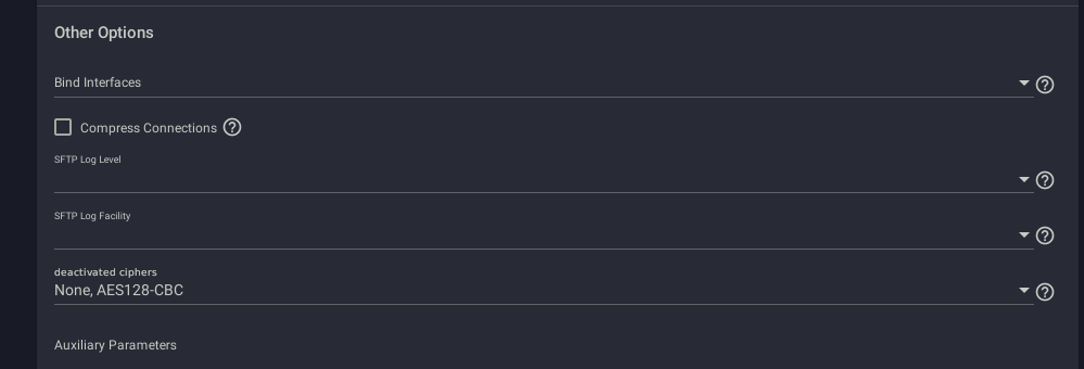

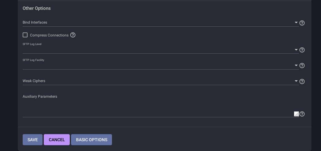

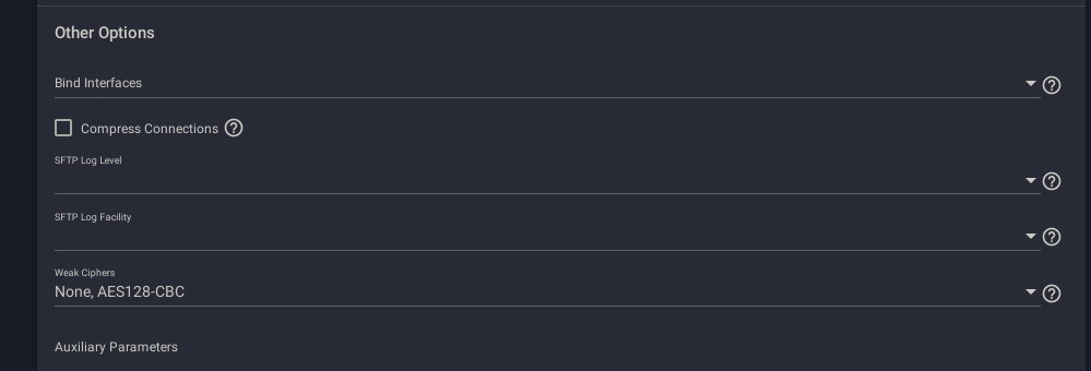

Because a picture can explain more than a thousands words, here are two examples:
Bad confusing misleading GUI design (the current situation):
Very good meaningful clear GUI design (how it should be):

Although your GUI mockups are clearer, I don't believe the ciphers are actually deactivated.

The first screenshot shows the setting how it is on a fresh install.

That's the configuration after a fresh install, when i press the drop down button of that "Weak Ciphers" entry:
"None" and "AES128-CBC" have both a checkmark set.
Because of the bad GUI it is still not clear, what the results of unchecking or checking these checkmarks are?
Are these Ciphers disabled by setting the checkmark, because that menu option is called "weak chipher" or are they enabled when setting the checkmark?

If you want have "None" and "AES128-CBC deactived it must look like this in the GUI:
and if you press the drop-down menu button it must look like this:
I can only repeat, the way this ssh GUI is designed is really bad and should be changed to make it clearer.
