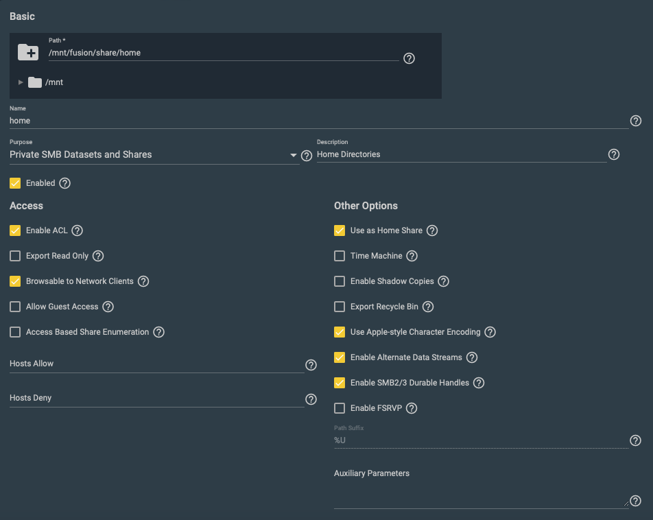

This is the definition of my home share:
When a user logs in for the first time (IIRC mounting any other share via SMB also works) a subdirectory named <DOMAIN>/<USER> is created. Placing the SSH credentials in there lets users log in.

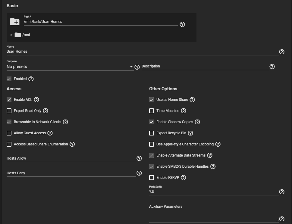

Thanks for your suggestions. I had the same settings apart from %U, which I've added, and "No presets", called for explicitly here - https://www.truenas.com/docs/core/coretutorials/sharing/smb/homeshare/
Tested again and verified that nothing is created under the intended /mnt/tank/User_Homes, but the user gets placed into /home/DOMAIN/user with an ssh password login (temporarily enabled). Frustrating that the only answer from support is "you can't".
