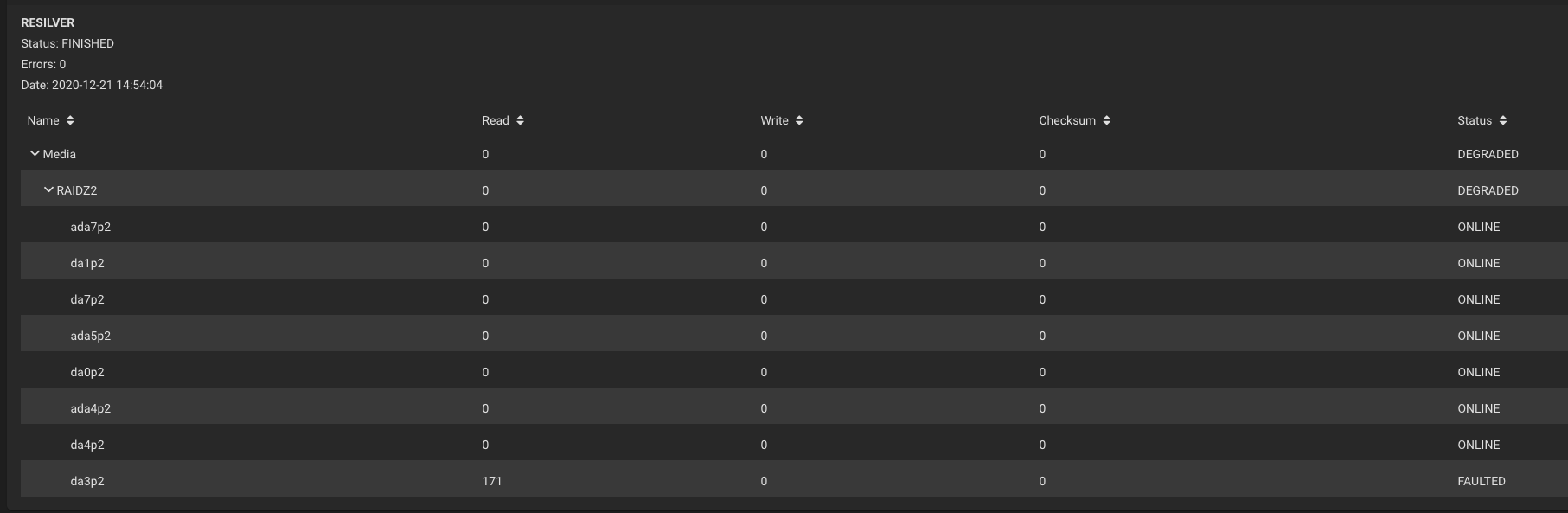

Now I have a "faulted" drive, after resilvering, in a different spot and a different hard drive. it's another WD drive. Ugh.
Pool Media state is DEGRADED: One or more devices are faulted in response to persistent errors. Sufficient replicas exist for the pool to continue functioning in a degraded state.
The following devices are not healthy:
Disk 11629615934624269482 is FAULTED
2020-12-21 19:38:05 (America/New_York)
@joeschmuck I replaced the drive before reading your post. Yes, only changed the drive...hot-swapped. I have not done any SMART tests.
thepixelgeek
Jan 21, 2016
271
Is it odd that only one drive has read values? Here's the output for the faulted drive, da3:

Drive da3 (S/N:WCC4E7ZD84ZZ) has not had a SMART Long/Extended test run on it. Run this test on all of your drives, you can do this for all the drives, just issue the command smartctl -t long /dev/ada0 and change "ada0" to each drive, do not add "p2". When you start each test there will be a message indicating how long it will take to complete this test, make sure you let it complete before cycling power to the drives. If you use the NAS then that will add time to the test. For example your drive above would take 517 minutes (Over 8.6 hours) if the NAS was just sitting idle, but if you used the NAS then you could expect to add time, how much depends on how busy the NAS is. For your drive I would let it run overnight. When you check the drive status again it will tell you when the drive performed the last test (recorded in power on hour time) and if it passed or not.
I don't understand what you are saying. Try again and be very descriptive with your words, you do not want me to make assumptions as that could easily lead us down the wrong path. If other SMART results look odd to you, then post them all so we can tell you if it's okay or not. Right now I'm assuming that you have never tested or rarely test your hard drives and just wait for them to fail and then hope someone can dig you out of a deep hole.
I hope things go well for you.
thepixelgeek
Jan 21, 2016
271
I posted an image with that comment. Guessing you don't see it? I went to storage > disks. The table shows read, write, checksum values...all my drives say "0" except da3 drive which states "171" under the Read column. Hope that helps.

Offline data collection status:  (0x82)    Offline data collection activity
                    was completed without error.
Self-test execution status:      (   0)    The previous self-test routine completed
                    been run.
data collection:         (  591) seconds.
capabilities:              (0x7b) SMART execute Offline immediate.
                    command.

thepixelgeek
Jan 21, 2016
271
After reading the HD guide it appears that da3 is not looking good.
# 1 Extended offline Completed: read failure 90% 6588 119447200
200 Multi_Zone_Error_Rate 0x0008 200 200 000 Old_age Offline - 29
Edit: And it has a new alert on my TrueNas dashboard > alerts:
Device: /dev/da3 [SAT], Self-Test Log error count increased from 0 to 1.
joeschmuck
Old Man
May 28, 2011
10,996
I agree, drive S/N: WCC4E7ZD84ZZ is faulty.
Also drive S/N: WCC4E0CPLJFH
12 Power_Cycle_Count 0x0032 070 070 000 Old_age Always - 30426
192 Power-Off_Retract_Count 0x0032 162 162 000 Old_age Always - 29092
193 Load_Cycle_Count 0x0032 189 189 000 Old_age Always - 34205
This drive obviously was powered on and off 30,426 times. This makes me think you grabbed an old drive that you abused (maybe a strong word but you get my point) for several years, well I hope it was over a long period of time and not over a month or something like that. Hard drives (spinning rust) like to run and will typically live longer if you keep them cool and leave them spinning.
Your other drives all look good. Make sure that you have automatic SMART tests set to run and periodically verify each drive to ensure that short and long tests are actually happening.
Good Luck!
joeschmuck
Old Man
May 28, 2011
10,996
If not already done, make sure you are setup for email notification on failure. It's in the FreeNAS/TrueNAS User Guide.
thepixelgeek
Jan 21, 2016
271
I'm now set up to do long SMART tests for all disks weekly, and short tests daily. Based on my usage this will be fine, for now.
I updated my email settings and I'm now receiving alerts. I had it configured incorrectly.
What settings do you recommend for SMART service options? Was reading the guide but not sure if I should change anything.
thepixelgeek
Jan 21, 2016
271
Yes, super old drives. I have two new drives coming this weekend to replace the bad drives.
Thank you for the help @joeschmuck. Much appreciated.
