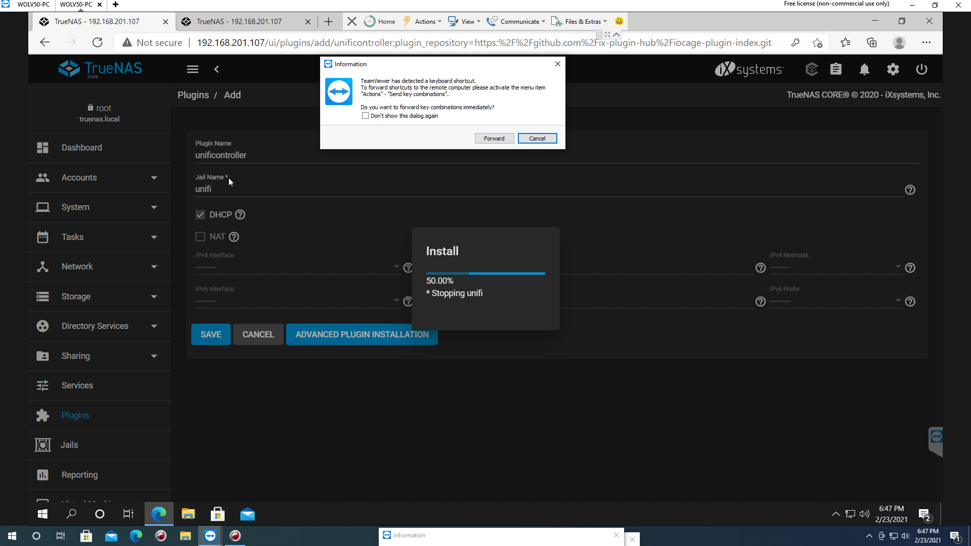

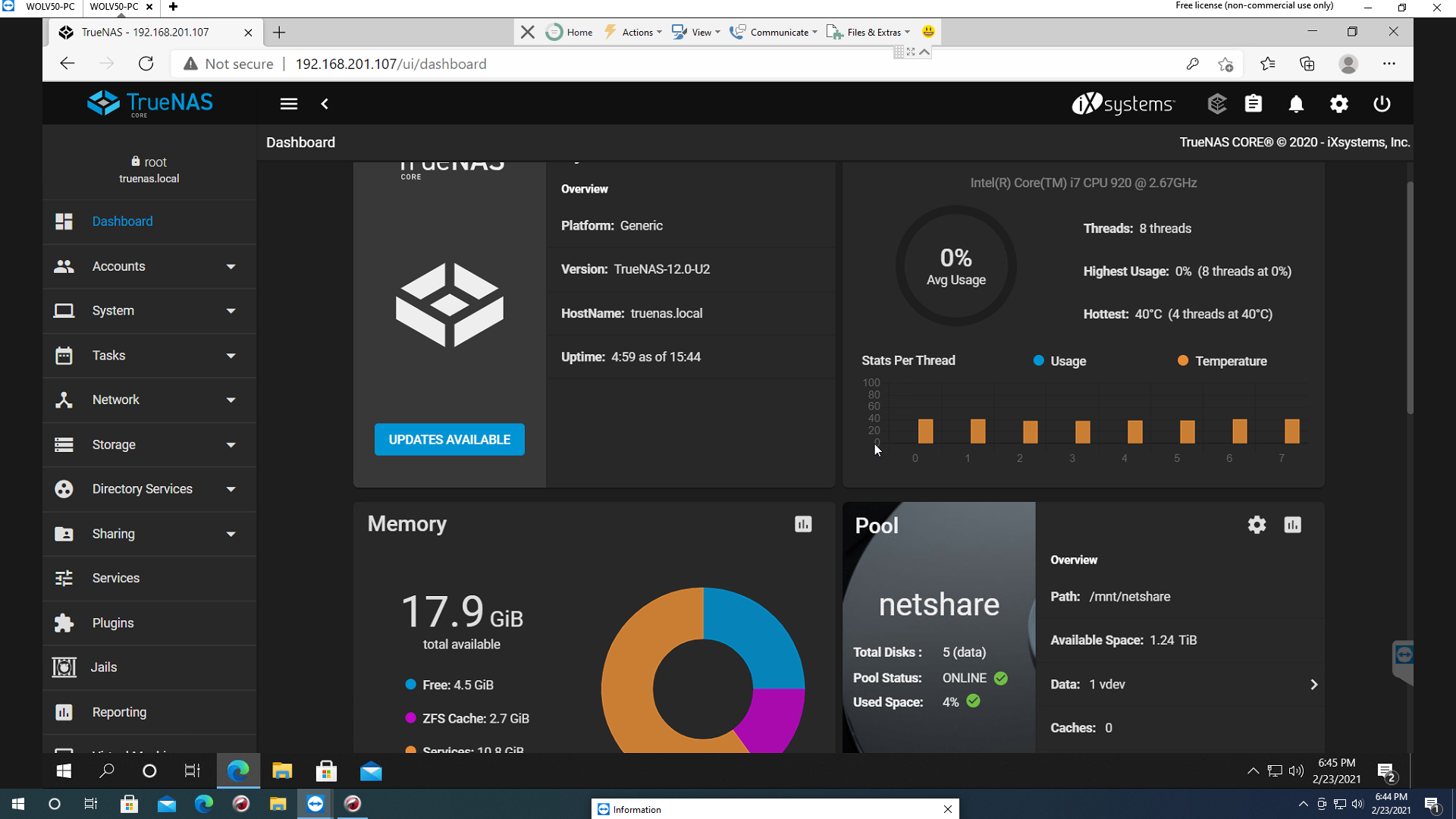

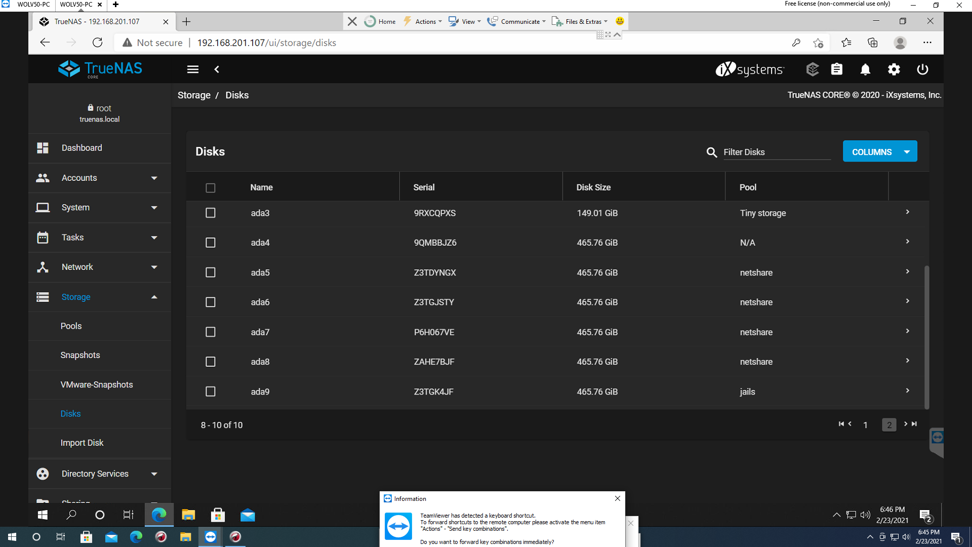

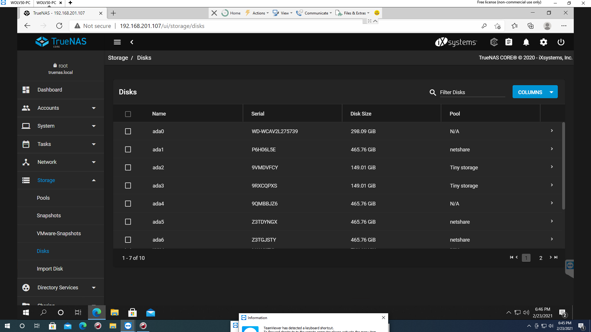

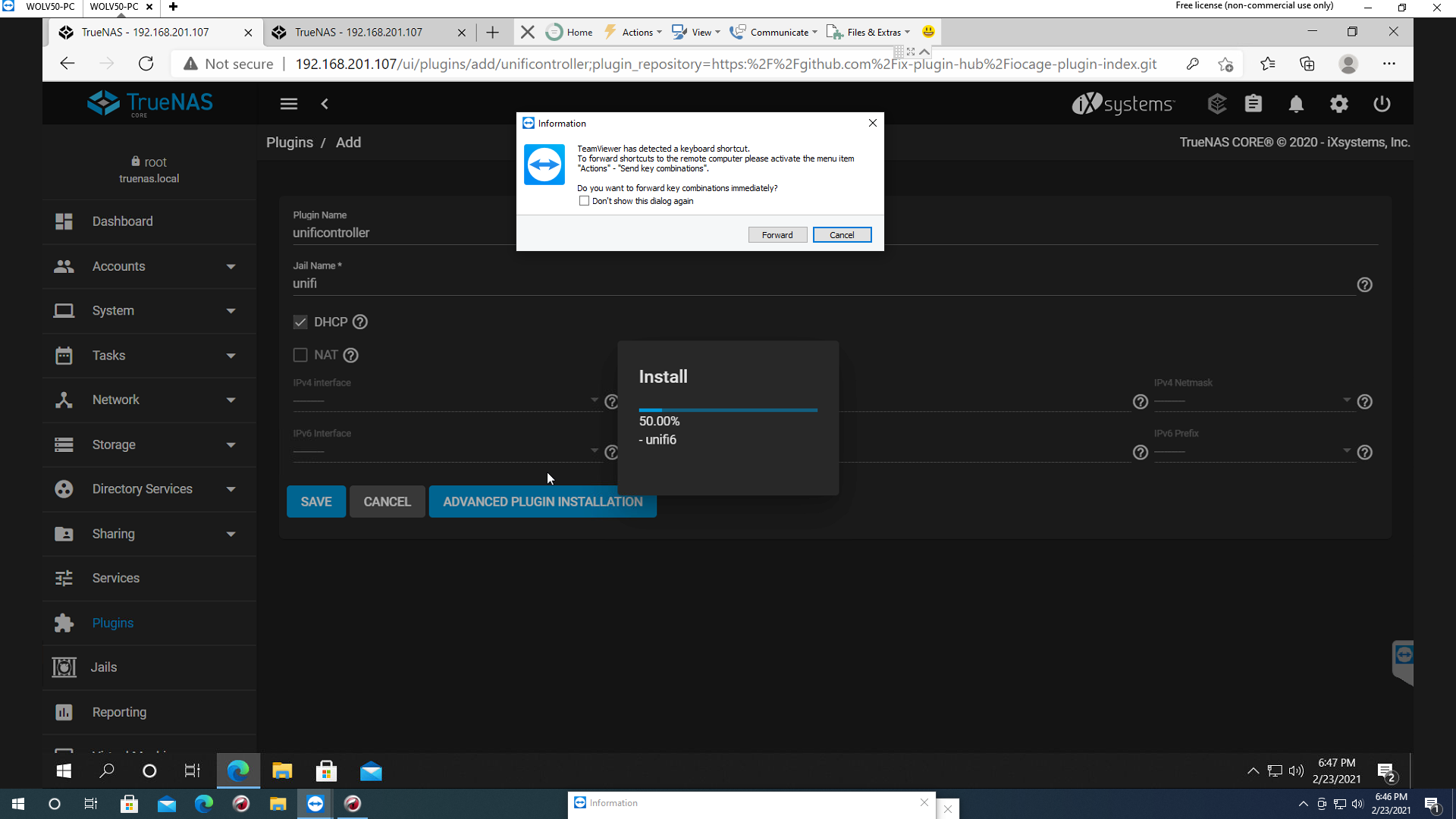

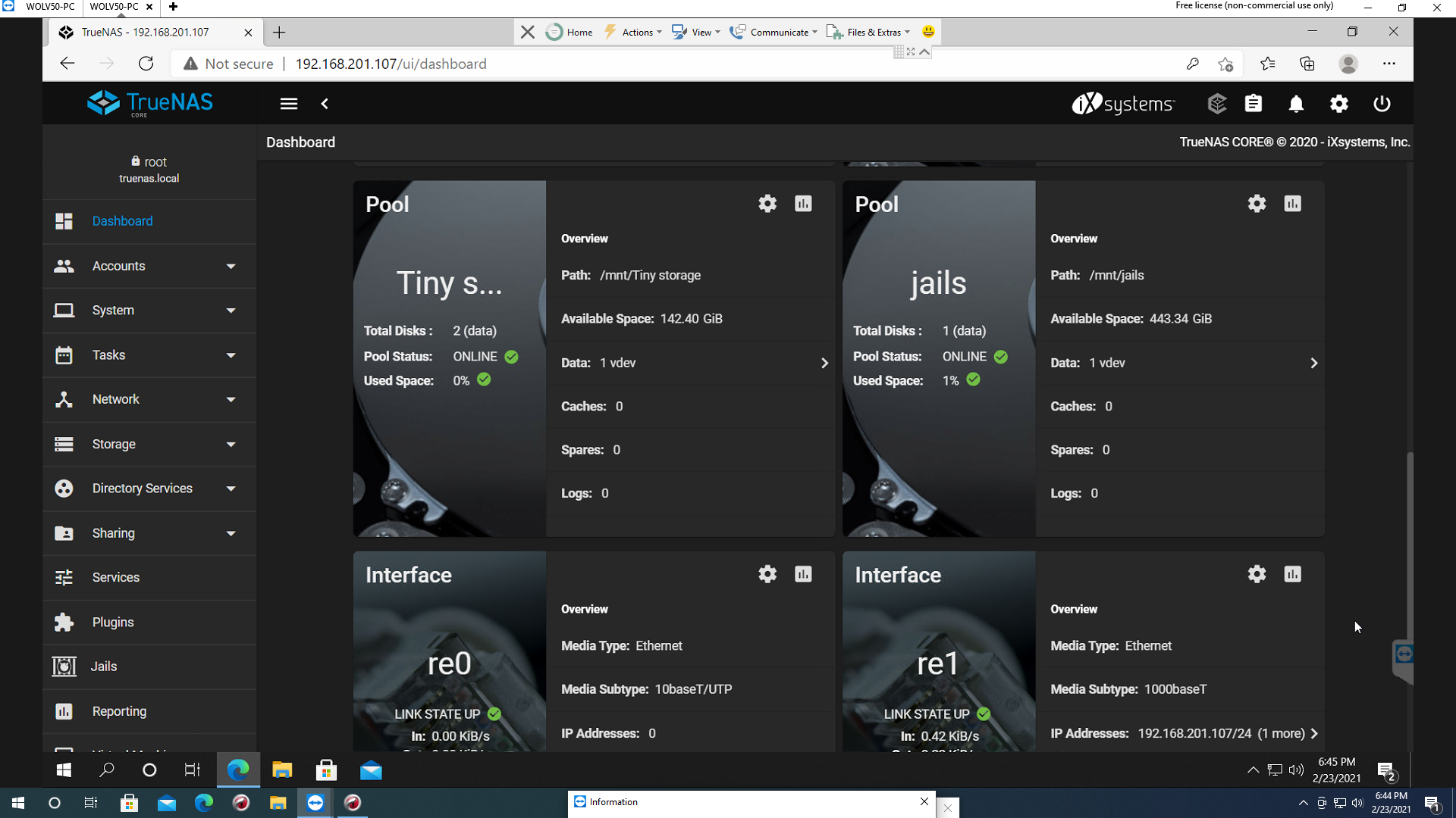

in plugins under comunity there are 2 unifi plugins ok for unifi-lts and the toehr is for unifi controller. the unifi-lts is an old software that doesn't work for newer systems. and the unifi controler plugin points to an incorrect package. during plugin install it attempts to install pkg unifi6 and it does not exist on the package store however unifi5 does and used to be the package that was installed in plugins, is there a way to have the plugin installer point to the previous package while installing the plugin? as installing in this matter makes the setup process go smoothly. due to a recent hardware failure I am forced to reinstall the plugin, but its not installing any more.
hardrives are of seagate design or western digital design. the failed HDD has been removed from the system this drive contained the plugin and jail data store unfortunately i did not create a backup a mistake i wont make again.
the install ends in Error: unifi had a falure Exception: RuntimeError Message: pkg error: -unifi6 : Refusing to fetch artifact and run post_install.sh! Partial plugin destroyed.
