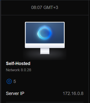

given:
freenas scale, ip 192.168.88.19/23
I have unifi controller installed on it, running on port 30072.
The unifi controller web panel shows IP 172.16.0.6.
the problem is that i cannot manage the access points that are running on the 192.168.88.0/23 network from the controller web panel.
I just have no experience with virtualised applications before
9,703
You need to go to Settings | System | Advanced, then look for "Inform Host": Set Override and give the IP address of your TrueNAS host.

1. I ticked "Inform Host" but it didn't help, the unifi controller gets the address from subnet 172.16.0.0.0/16 (I would add it to the bridge but I have this subnet busy for cameras)
2. subnet /23 is correct as I have more than 300 devices on my network.
9,703
That's why you need to tell it to advertise the IP of the TueNAS host as I already said.
