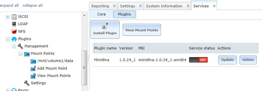

csani
Jan 21, 2013
4
Thanks for your efforts Joe.
Unfortunately even with the minidlna installed i do not have any reference to it under Services → Plugins → Management.
Why?!

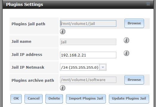

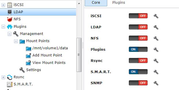

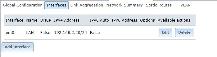

Will, here you go, please let me know what I am doing wrong...

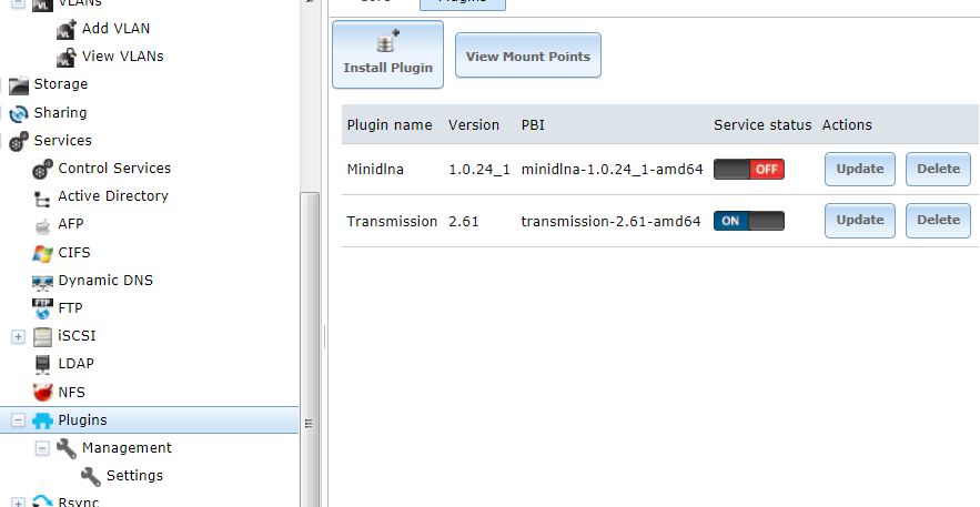

Please see that even if the plugins service is now running the plugins arenot present in the tree under Services->Plugins
