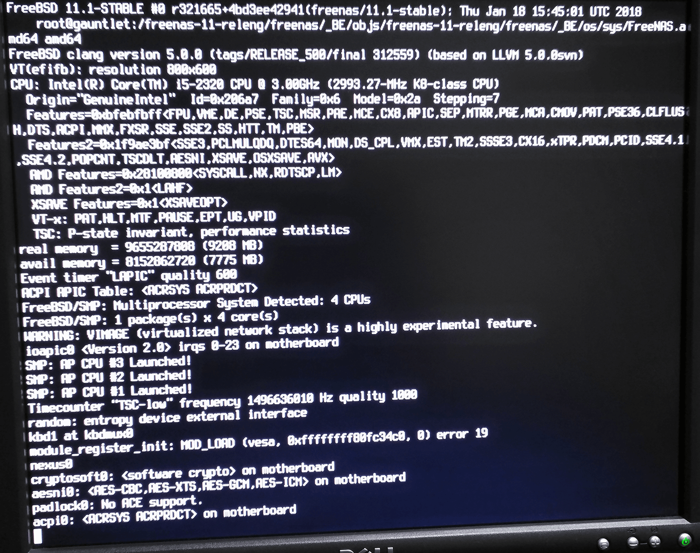

I used to have FreeNAS on an older computer, which worked for what I needed it for. I now have a "newer" computer (consumer-grade) that I'm trying to install FreeNAS 11.1-U1 onto.

I'm not sure what else to provide that might be helpful, as I don't think there are logs, but please correct me if I'm wrong.
Basically, does anyone have any ideas for what I might be missing or should try next?

Just tried using DD Mode, and I get the same screen as pictured above when getting just past the option of "FreeNAS Installer" or the Serial Enabled mode.
When in ISO Mode, I'm able to completely get through the installer and reboot into the drive where FreeNAS was installed to, and then the above pictured screen appears.
