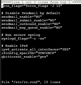

evirc
Dec 20, 2023
15
I inserted the writing underlined in red, but every time I restart I find the writing underlined in blue. I have to start the service manually to make everything work, and after a while it becomes unreachable
this is wrong, i delete the second row. thanks @victort
but at the restart, the service will not start, and after few time, the jail is up but the ip is unreachable

I tried to reconfigure everything, restarted TrueNas, but still nothing...credentials are ok, but it doesn't start at startup... how can I fix it?
Oct 22, 2019
3,641
So when you restart the jail, qbittorrent-nox doesn't run automatically?
evirc
Dec 20, 2023
15
exactly, the jail starts automatically but qbittorrent needs the 'service qbittorrent-nox start' command to work. I also tried changing the script as in this guide, but nothing. I also tried restarting truenas, but nothing changes.
