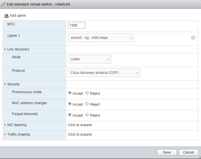

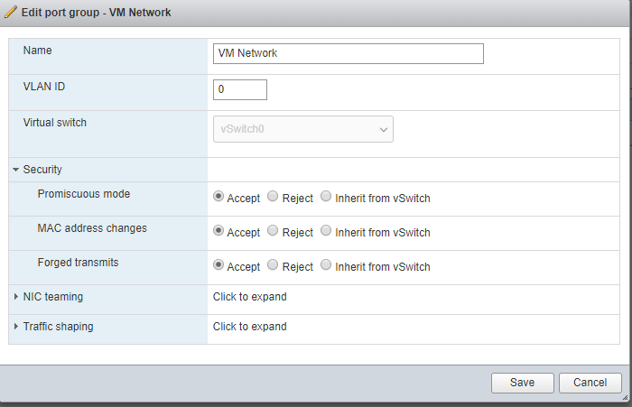

I just got my issue fixed and maybe you have the same one.
Likely covered / thought of, but doesn't the Port Group assigned to the FreeNAS VM need to contain both the following with VNET?
  • Promiscuous mode = Accept (or "Inherit from vSwitch" provided set there)
  • Forged trasmits = Accept (or "Inherit from vSwitch" provided set there)
bbenz3
Member
Jan 22, 2012
69

I actually have one of those I can reach out to but I think I have figured out how to do it the correct way. First you create a new port group just for the FreeNAS box and you setup the security on it so that it function the expected way. Then you connect that port group to the switch that has your internal LAN physical nic attached. Essentially you are creating multiple port groups on a single virtual switch thus allowing you to setup different security architectures on the different port groups.
