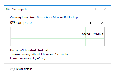

When I have created the Windows Storage (SMB) and copying the 400GB file to test the storage speed then getting only 191MB/s speed.
Can you please suggest why I am unable to get the speed on FreeNAS Storage?

Data transfer speed is : 189-191MB/s
