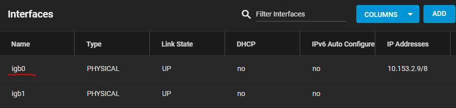

The physical interface I want to use is igb0

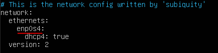

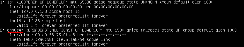

In Ubuntu, interface shown by `ip a` matches interface in /etc/netplan/00-installer-config.yaml
