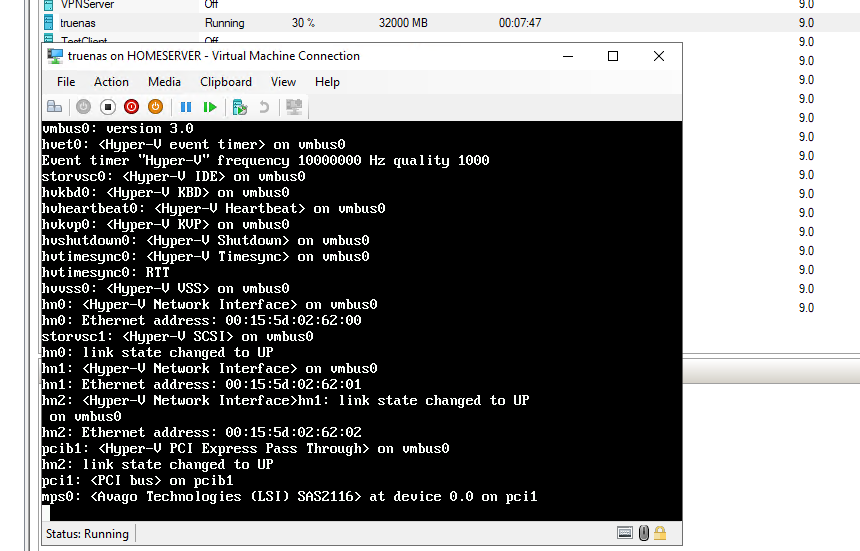

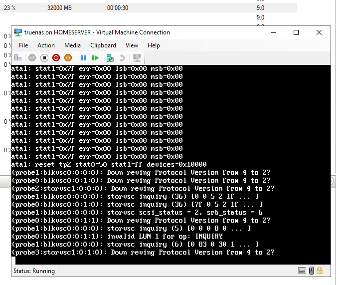

After my Upgrade to 12.0 U8, the truenas instance seems not to be able to boot - it seems to stuck forever mounting the LSI with 1-2 Cores maxed out.
Any ideas? Already dismounted the PCIe device and Truenas loaded like it should.
This release seem to have a critical bug.
Help would be appreciated. Need to boot up at least the elder release else my data is not accessible.
Thanks!
hanging like this the system seem not to react on crt alt del at all. So i can only hardly reboot the VM.
Edit: If I map the LSI to an other VM it works fine. So it has to be releated to the Truenas Update

dmesg:
pcib1: <Hyper-V PCI Express Pass Through> on vmbus0
hn2: link state changed to UP
pci1: <PCI bus> on pcib1
mps0: <Avago Technologies (LSI) SAS2116> at device 0.0 on pci1
mps0: Firmware: 20.00.07.00, Driver: 21.02.00.00-fbsd
mps0: IOCCapabilities: 1285c<ScsiTaskFull,DiagTrace,SnapBuf,EEDP,TransRetry,EventReplay,HostDisc>
pcib2: <Hyper-V PCI Express Pass Through> on vmbus0
pcib2: chan19 is revoked, when it is being opened
Trying to mount root from zfs:freenas-boot/ROOT/12.0-U7 []...
Root mount waiting for: CAM
pcib2: failed to open chan19
device_attach: pcib2 attach returned 6
