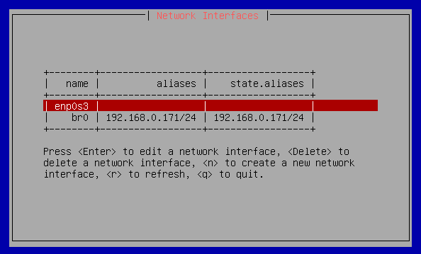

I'm kinda smacking my head into the wall on this one.
Now, I've learned that it's nearly impossible to setup a bridge and have it stick in the webUI. It will basically time out and reset it self. So off to the console "1 Configure Network Interfaces".

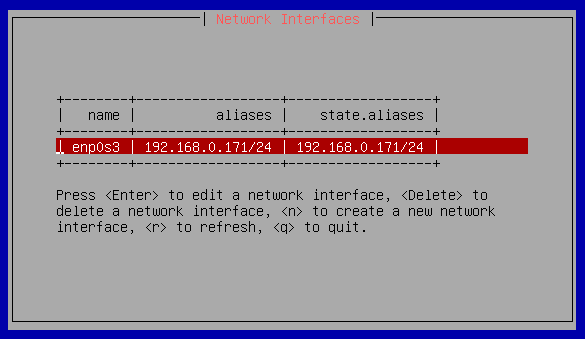

So I manage to get it to look like this.
I want a properly bridge network so that I can basically get to the NAS from the VM's. A perfectly normal thing to want to do. I want my VM's to consume the services I actually deploy on the NAS.
Which from what I understand should work perfectly. It doesn't.
- I loose all access to the webui on Truenas.
- The True nas host is not pingable on 192.168.0.171
- From the Truenas linux shell I can not ping anything.
- And obviously I have no access to my VM's or any other service on the NAS now. Because the network is basically broken.
So basically I have no networking at all.
Now If I remove the bridge in the cli the webui comes back to life. I can ping etc.
- But now the VM's are effectively pointless.

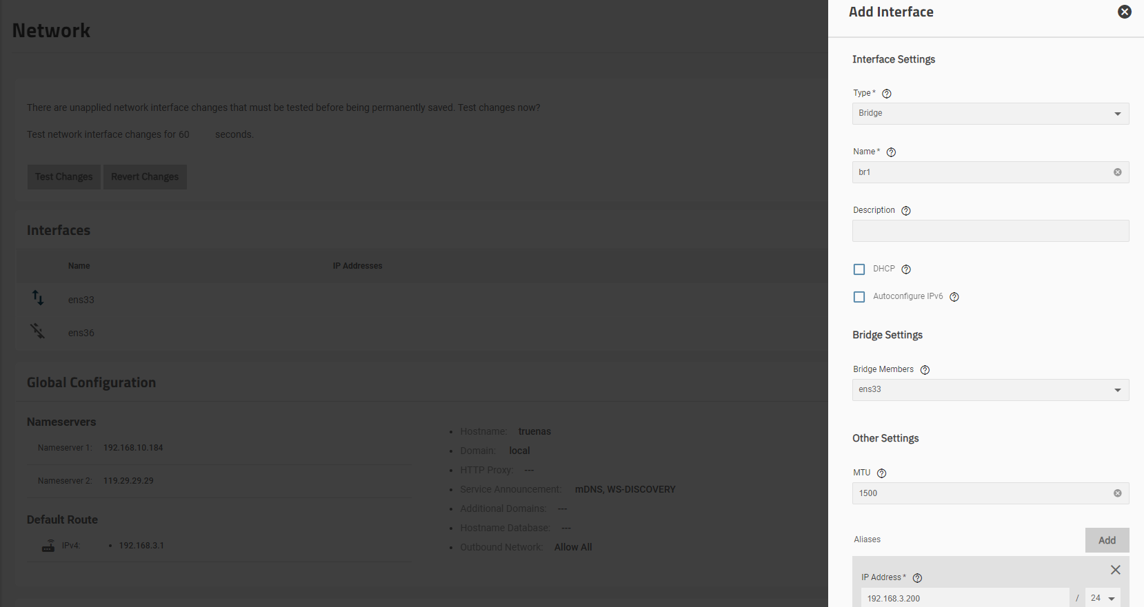

This is not correct. It works fine from the GUI if you do it right.
I can't see from your screenshots what member interface you set in the bridge (if any). You need to have enp0s3 as a bridge member or nothing will work.

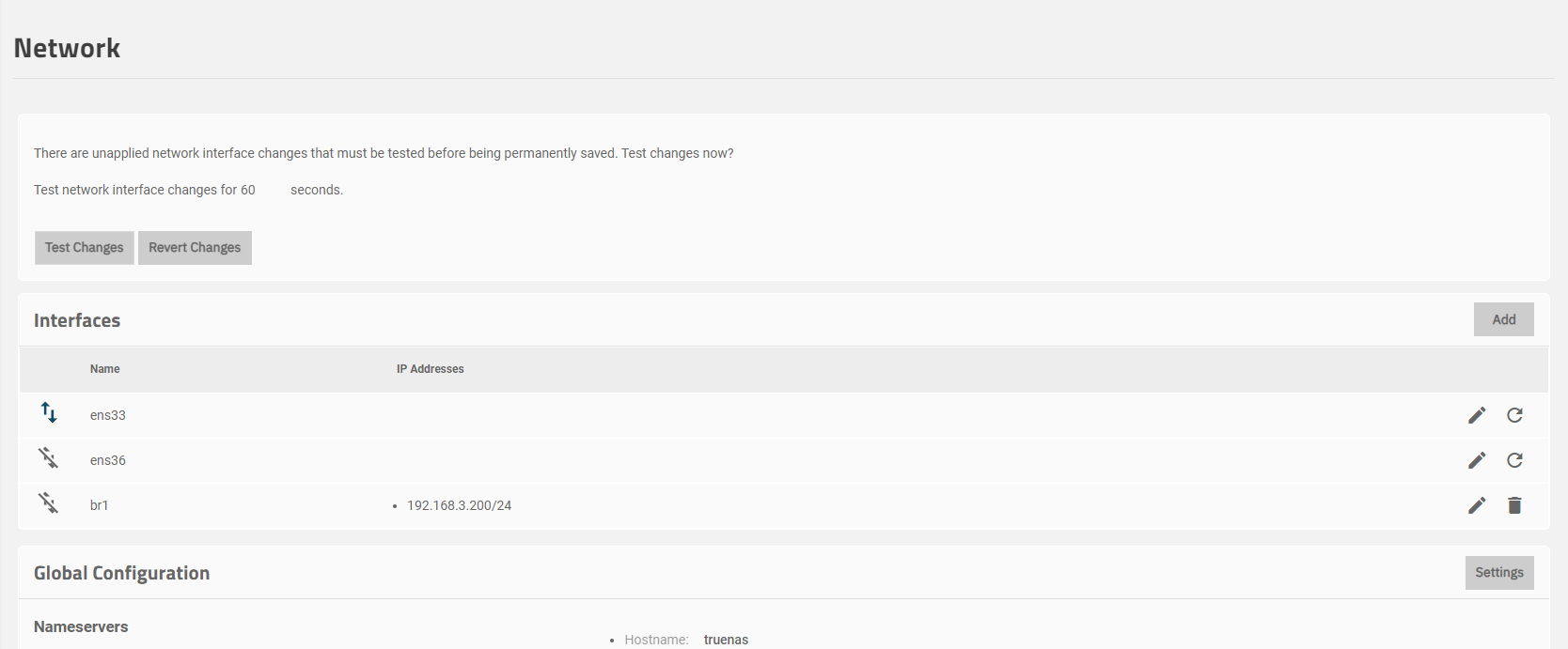

Because I lose access to the interface I no longer am present a save and keep style option. So it times out and resets. I've seen the videos of it working for people and I go tit to work on a completely different machine. But since the interface is no longer accessible once you "test" it resets for me.
So No on my setup I can not use the gui. I have to use the terminal.
enp0s3 is the bridge member.
Traffic forwarding simply does not work.
Now when I try this on a completely different host I got the bridge to work. Using exactly the same process. This is a new development btw. I'm most likely going to rebuild the host. As I no longer trust the install. I'm working on the assumption that I must have mangled something while trying to figure out why VM's had no access to the host. Only to learn I needed a bridge. My hand is up for this to be stream lined in the gui. Because it is not at all obvious this is where you need to go to get VM's functional. And by Functional I mean having VM's being able to access mass storage.

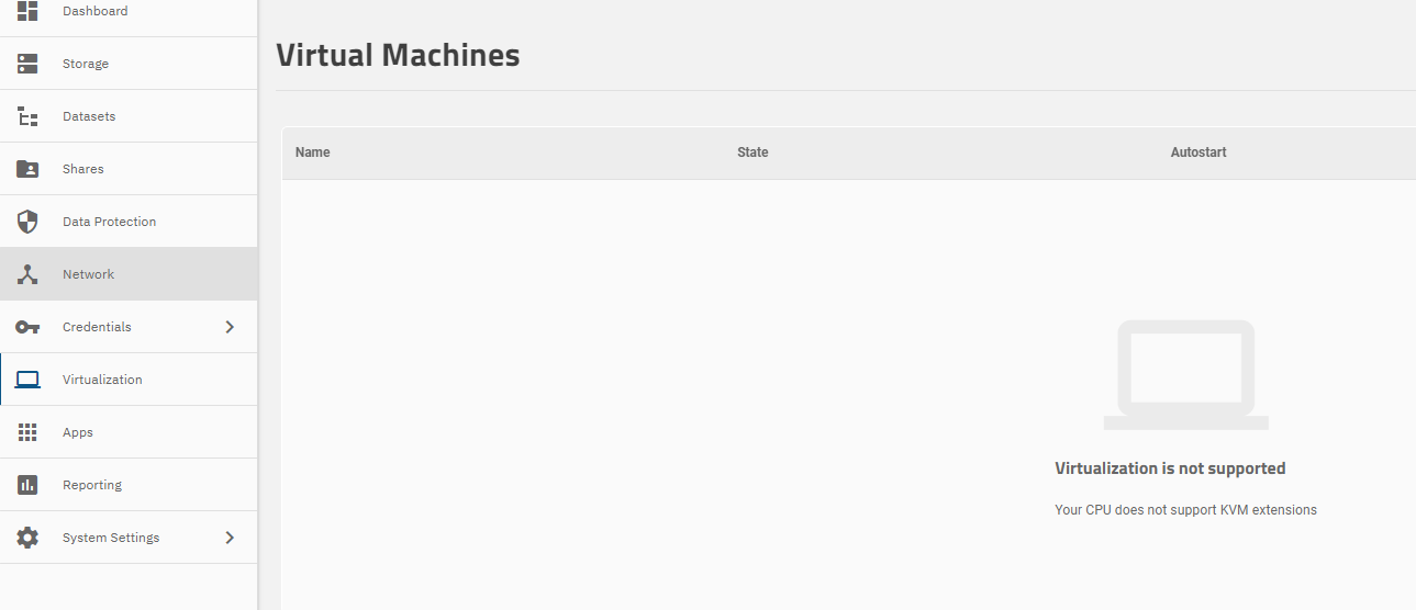

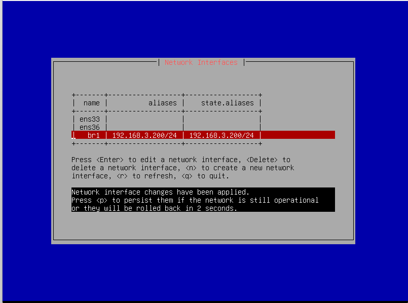

Please help me, I have closed all apps and the cpu does not support virtual machines. But I still can't successfully set up the bridge interface
I can't access web ui again until it times out
9,703
Are you pressing "p" on that last screen to persist the changes?
