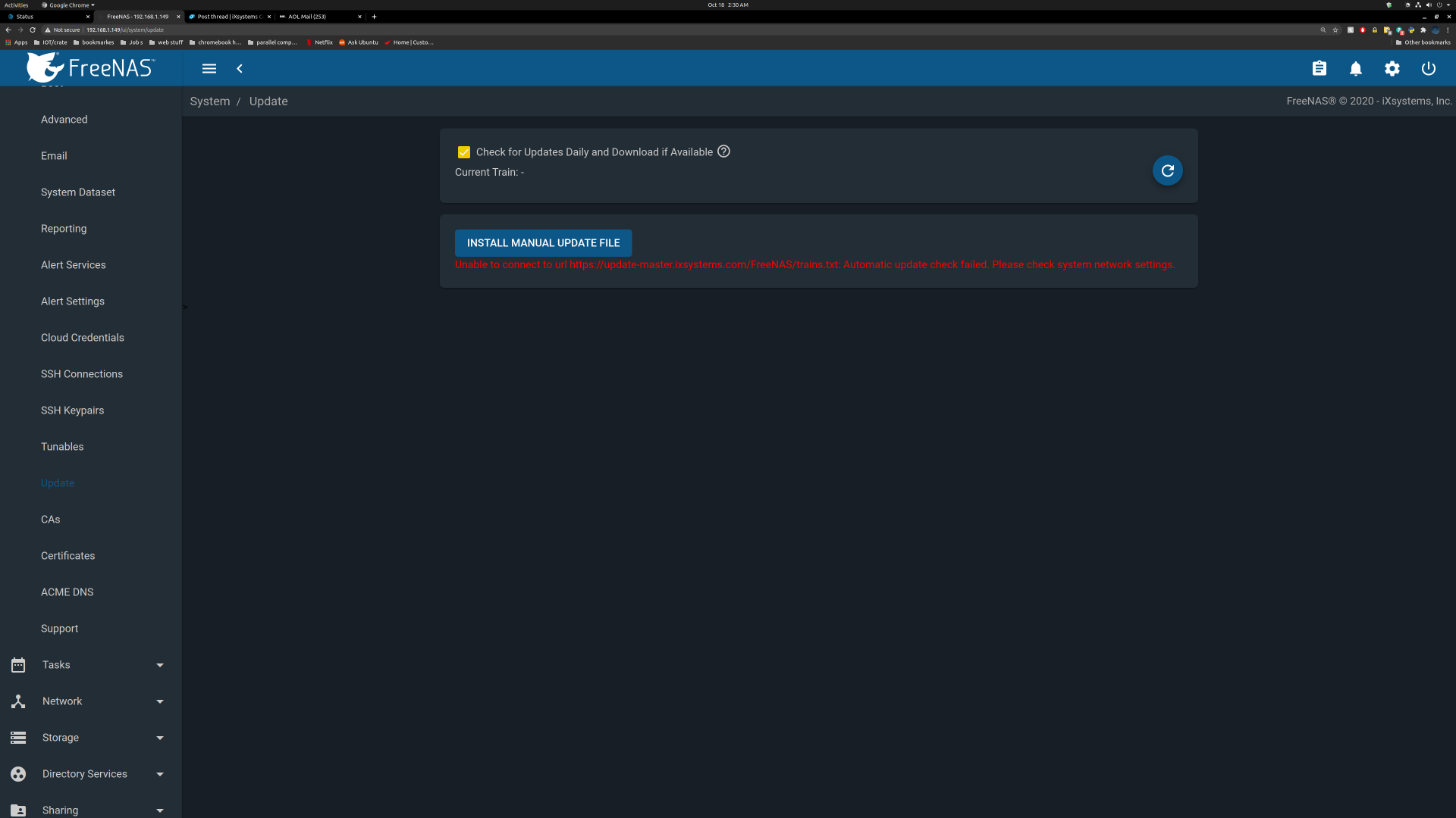

Unable to connect to url https://update-master.ixsystems.com/FreeNAS/trains.txt: Automatic update check failed. Please check system network settings.

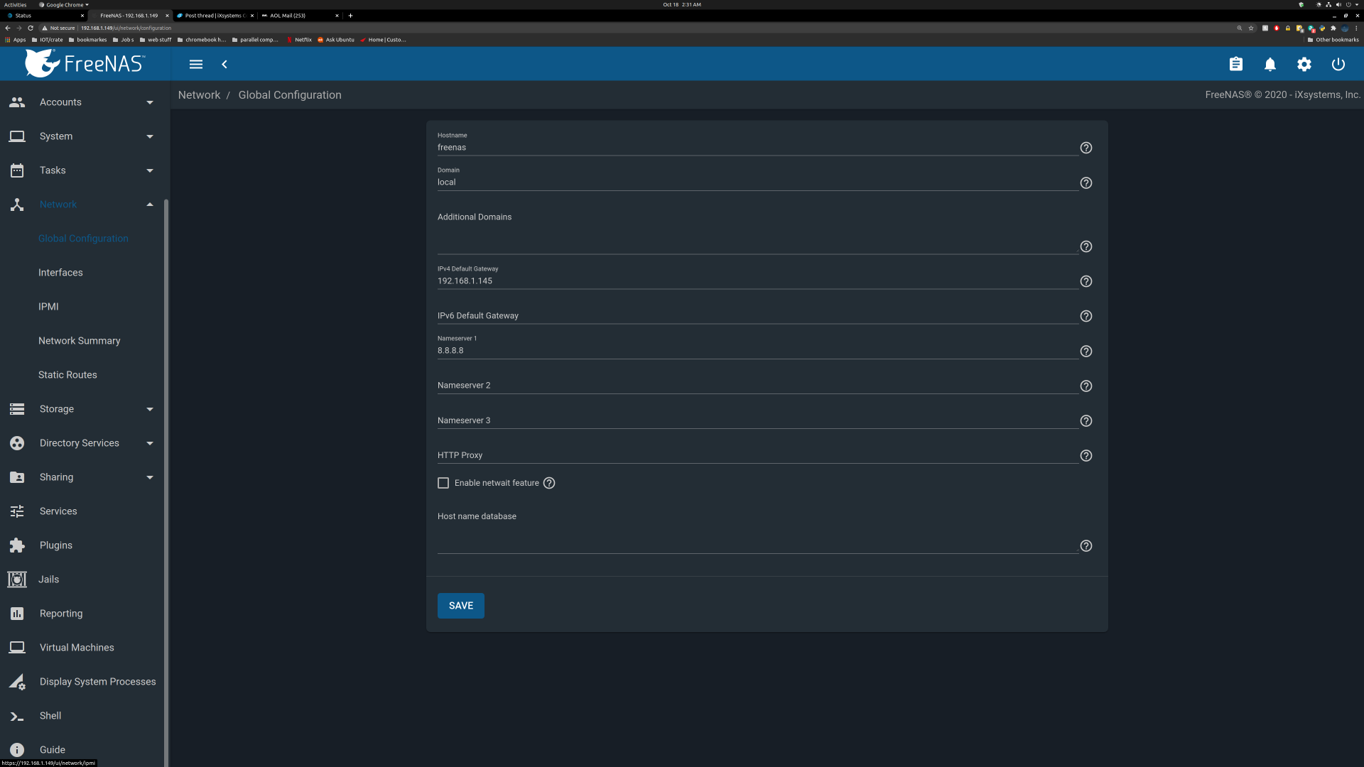

i cant update i am running a dl360 g5 server.

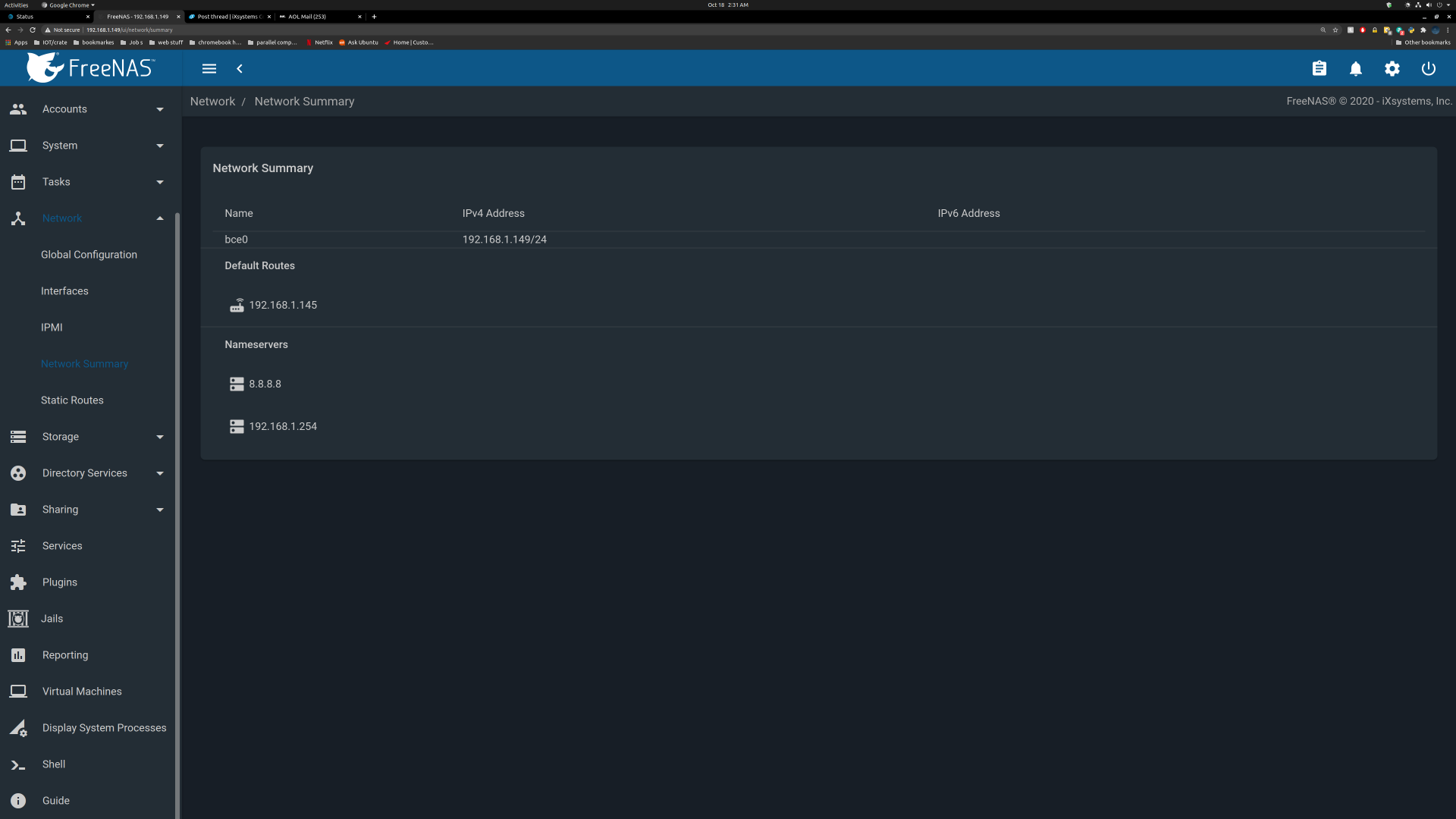

Could be a wrong default route. It says 192.168.1.145. Is that right?
Your DNS settings show a nameserver at 192.168.1.254.
As you did not wrote anything about your network setup everything here is a wild guess.
Are you connected with a DSL router? The usual (default) setup would have the router at the
lowest IP in the range, sometimes it is in the highest IP in the range.
As there is a nameserver at 192.168.1.254 try that as default route or try 192.168.1.1.
If they don't work you'll need to provide more information about your network setup.

No the 254 is my rounter and yes I have it connect to a DSL router. And my server is connected to a switch running a vlan and that vlan is connected to the router.i can ping the server with ease but it's still haveing the problem.

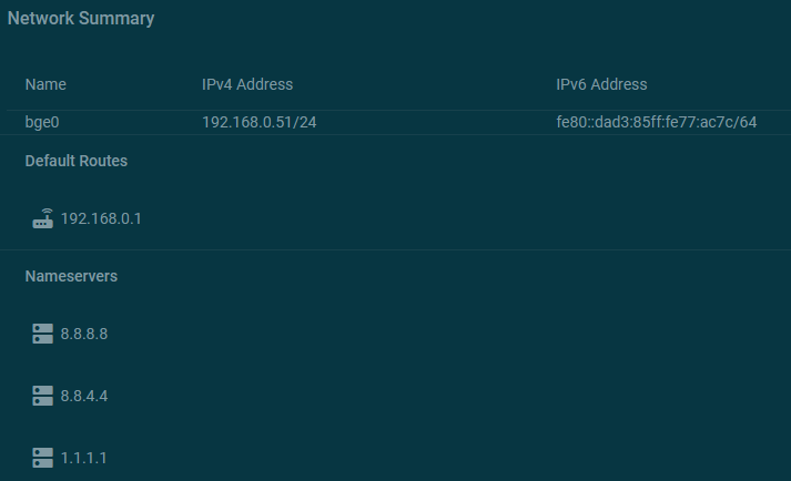

I am having the same issue with not being able to connect to the update server. However, I can send a test email and can also ping the update server.
root@VLfreenas2[~]# ping update-master.ixsystems.com
PING update-master.freenas.org (38.126.124.199): 56 data bytes
64 bytes from 38.126.124.199: icmp_seq=0 ttl=45 time=173.828 ms
64 bytes from 38.126.124.199: icmp_seq=1 ttl=45 time=173.957 ms
64 bytes from 38.126.124.199: icmp_seq=2 ttl=45 time=173.697 ms
Any help please?

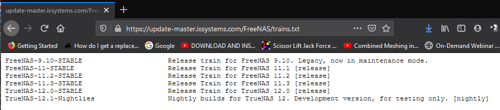

I can also open that address directly in my web browser so it should work.

Same exact problem, but different symptoms;
If I wget that file in the FreeNAS CLI it pulls down the same page I see on other computers.
So why is the update failing?
Potentially related background; I did change DNS on this network earlier but I have updated the network global DNS info. I also rebooted FreeNAS. The ability for wget this worked before and after the update.
