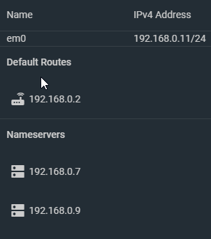

ozwald
Jun 11, 2015
14
Hi guys,
I seem to be having this same issue. Any ideas?
I am currently running:
I am able to ping google from the shell:
I am able to hit the listed website through chrome:
my internal ip settings:
.02 is my router
.07 is DC01
.09 is DC02
Samuel Tai
Apr 24, 2020
5,399
