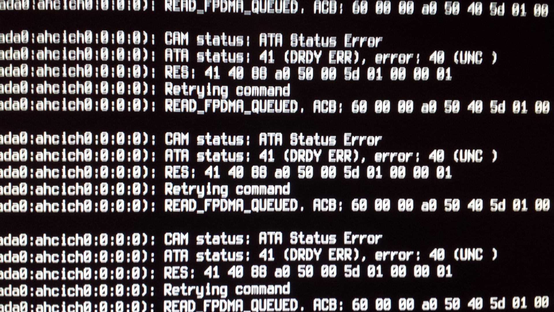

I recently wasn't able to connect to my FreeNAS, so I borrowed a monitor from work to see what the problem was. I found an error that turned out to be an issue with one of my 2 drives. In trying to find out what the problem was, I did a clean install of FreeNAS on the USB drive. Eventually, I was able to get it booted up, but only using 1 of the 2 drives. When I went to the GUI, it made me set up a new share. For some reason, I can connect to the drive, but not the old folders. When I use the GUI, I can see the old folder structure and their sizes, so I know the information is still available. I am looking for a way to get to the old folders and temporarily transfer the files to an external drive, so I can get 2 new drives for the NAS.

Attached is a pic of the error I was getting. When I looked into it, I found that was possibly a connection issue to one of my drives. I attempted to start up with each drive in alone and with no drive in, but nothing worked. I installed a new copy of FreeNAS and tried again. I found that I could boot up with one of the drives, but the GUI made me go through the setup wizard and create a new share. I can see the new and old share in the GUI, but I can't access the old share from my computer. I want to get my files off, so I can start over with 2 new drives.

[root@freenas ~]# zpool status
pool: FreeNAS
state: DEGRADED
status: One or more devices could not be opened. Sufficient replicas exist for
the pool to continue functioning in a degraded state.
action: Attach the missing device and online it using 'zpool online'.
see: http://illumos.org/msg/ZFS-8000-2Q
scan: scrub repaired 0 in 0h51m with 0 errors on Sun Aug 7 00:53:22 2016
config:
NAME STATE READ WRITE CKSUM
FreeNAS DEGRADED 0 0 0
mirror-0 DEGRADED 0 0 0
8306981635671541791 UNAVAIL 0 0 0 was /dev/gptid/dafce66f-9719-11e5-890d-28924a360
5b4
gptid/db8d12ec-9719-11e5-890d-28924a3605b4 ONLINE 0 0 0
errors: No known data errors
pool: freenas-boot
state: ONLINE
scan: none requested
config:
freenas-boot ONLINE 0 0 0
da0p2 ONLINE 0 0 0
Also, I just tried to connect to the drive and it came up with "Select the volumes you want to mount on '192.168.1.70':". It gives me the choice of homes and root, but neither will connect.
