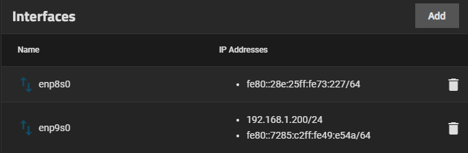

I have 2 phyiscal NICS, one to my network and this works fine, allocated via DHCP. Standard 1 gig interface
I installed a RTL8125 Realtek 2.5gbe and i wanted to get truenas to configure this on a static IP, in the same /24 i setup on my Windows PC. This link isnt going via a switch, or router, its purely direct connect.
Both interfaces show up in TrueNas, happy days. enp9s0 is onbaord 1GBE and enp8s0 is 2.5GBE

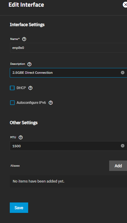

When i edit the enp8s0 network to unselect DHCP, hit save.

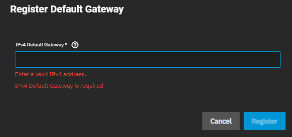

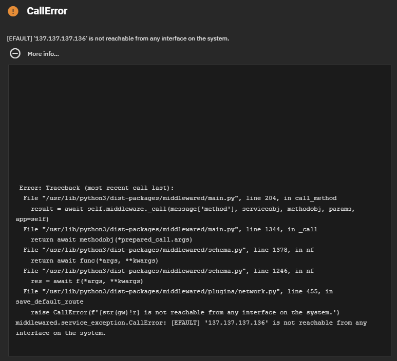

I'm immediately prompted to specify a default gateway. Well, given that this is a direct connection it technically doesnt need one, but ok. I use the IP of the interface on my windows machine so that it gets a reply, but it just throws an error saying its not valid.

Its very strange indeed, but it is actually doing some sort of validation, which i find weird as to why it does it. I've tried /32 the IP and even just putting 0.0.0.0 in as gateway. I even tried actually giving it the IP of the other device (which pings from shell) as the gateway so that it actually gets a response, but still fails.

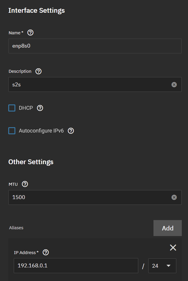

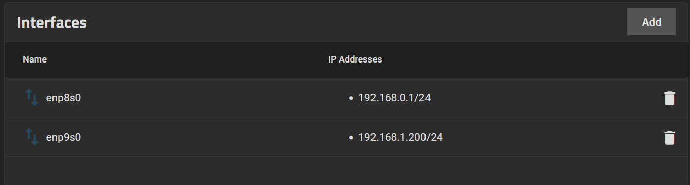

My setup is almost identical as yours, 1G (enp9s0) interface to router, and 2.5G (enp8s0) for server to server connection only, and mine is working. You need to set an alias for the 2.5G nic (aka configure a static ip). Then you won't be prompted to use a gateway. Here is a screenshot of my settings. My windows machine is on 192.168.0.2, and my 2.5G NIC on Truenas scale set to 192.168.0.1. You mentioned your NAS IP would be 137.137.137.137/24, you should use that as your alias. If you did that and still doesn't work, try configure your 1G NIC to use static ip as well (that where our setups are different). My windows machine is configured to use 192.168.0.1 as a gateway, and static ip of 192.168.0.2, but I don't think it makes a difference.
