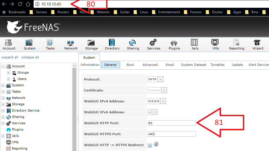

https://doc.freenas.org/9.3/freenas_system.html#general
Isn't that what the whole first section is about? Setting up HTTP or HTTPS for the WebGUI?
Gonna look at that later (trying to find how to change the port from the shell ;) ). Look at: /etc/local/nginx/nginx.conf. It will have the port you've setup there. You can change back to 80 to test and restart nginx. Don't reboot the server as it will revert back to whatever is in the middleware database. Access the gui, change to 80 there and will survive a reboot.
By the way ... I just did that on my test fn11 and worked, but can't assume any responsibility for anything going wrong with your server ;)
