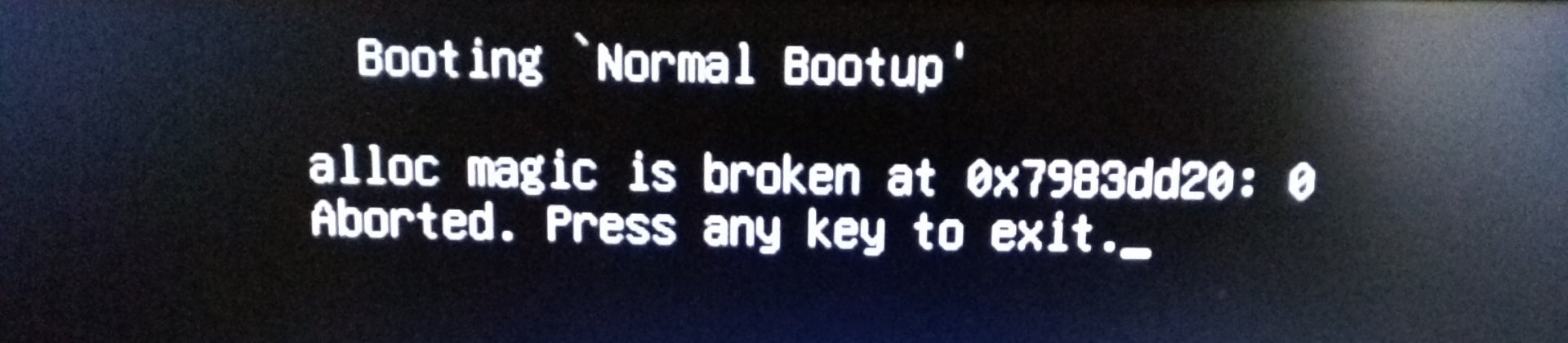

My server was down for a while due to RMA'ing the serverboard, and I got everything reinstalled yesterday. I immediately did an update via the WebUI from 11.0 to 11.1. Installation went fine, however upon rebooting, GRUB returns the message:
	Booting `Normal Bootup'
alloc magic is broken at 0x7983dd20: 0
Aborted.  Press any key to exit._
  • The boot devices are mirrored 32GB PNY Turbo USB3 drives
  • I assumed something went wrong with the update, so I reinstalled 11.1 from a USB, and upon rebooting, same exact error
    • I think the hex location was different each time, but I could be wrong
Is there something I need to edit in GRUB before it tries to boot FreeNAS?
  • To rule out a dirty RAM contact, I removed the 4 DIMMs, cleaned the contacts with alcohol, and reinstalled; however the same error, with the same hex code/location, is displayed.

I'm getting same error at a different address space with the 11.0-U3 install media, so it appears this is either related to the USB drives I'm using for the boot disk or RAM.

The issue is UEFI and GRUB, as it appears there's a misconfiguration of GRUB to load a UEFI install. Selecting BIOS as the install method works perfectly fine.
I'll open a bug report in the morning and post the link.
That's weird, I have an 11.0-U4 install on UEFI and everything works.
zoomzoom
Sep 6, 2015
677
It's also not isolated to the two PNY (USB3) drives, as I also tried two different SanDisk (USB2) drives, and a 120GB 850 EVO. All four USB drives, if installed with UEFI selected in the installer, failed with the alloc magic error, but if BIOS was selected in the installer, booted fine.
Even weirder, with the 11.1 install media, when I installed to the 850 EVO, which had previously been apart of a single drive pool for backup logs, the install would complete successfully, but when it went to boot, it came up as (paraphrasing) "this drive is a NAS drive", like it's still apart of a pool, and refused to boot. I installed to it twice and each time, the same error.
  • I did verify each time that I was indeed selecting the 850 EVO, as it became far more efficient to simply load the boot menu and select a drive, rather than go in the BIOS each time I tried a different boot disk.
These two things seem to imply there's something wrong with GRUB in the 11.1 install media that causes issues when selecting UEFI install inside the installer, or when it updates a UEFI 11.0 install to a UEFI 11.1 install through the WebUI.

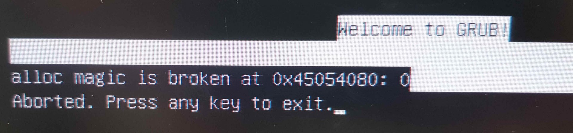

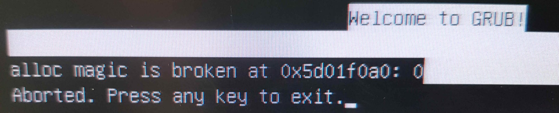

getting the same error, after rebooting my server.
Welcome to GRUB! alloc magic is broken at 0xZZZZZZZZ: 0 Aborted. Press any key to exit.
Specs: Asus P10S-X mb, with 4401 BIOS, in UEFI mode (CSM Support --> Disabled)
CPU: Intel Xeon E3-1220 v5
RAM: 64 GB DDR4, ECC, Kingston
BOOT drive: ADATA SU800 120GB and PATRIOT Burst 120 GB in mirror connected to mo.bo SATA controller
Data Pool: a lot of disks on an intel RS3WC080 controller and an intel expander, but I think this is not important at the moment.
FreeNAS version is: 11.1-U6
I'd like to apply the U6.3 update, and before that I thought it would be nice, to give a reboot to the server. So I rebooted it, and from that point I getting this error.
On my second FreeNAS device, which is an older, therefore not UEFI enabled, this process (reboot, apply the update) went smooth.
Is there a way, to get grub working again, or my best option to reinstall and reconfigure FreeNAS?
