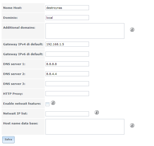

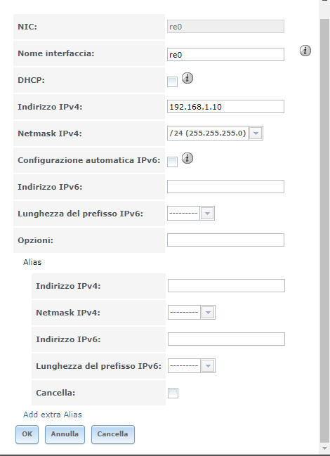

In FreeNAS I can just select in the NIC device between "Virtio" and "Intel" and none of them works.
I also tried to boot from a live ubuntu cd with a graphic server and it couldn't connect.
It's important to specify that: My FreeNAS is connected to another PC through ethernet and this PC share to it the connection. If I ping from FreeNAS shell everything is ok.

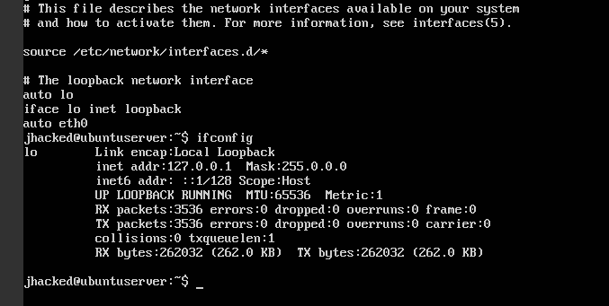

I'm gonna post:
/etc/network/interfaces
ifconfig
of the vm

And now the network configuration from FreeNAS:
