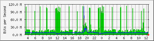

I got rsync working with the push/pull setup. I have two issues though.
First issue is the rate at which the data on the push box gets sent to the pull box. It's very inconsistent. I can't seem to figure out what's causing it to jump all over the place. I've checked the nic's in both boxes, even had HP come out and replace the mother board on the pull box because i was certain the nic's were bad. I've tried numerous switch ports - no difference. My 2 freenas boxes are used as such - Veeam backs up to the push box and gets great speed doing so. The pull box takes the backups from the push box. The push and pull boxes are in different buildings, both connected to gigabit cisco switches and the buildings are linked by gigabit fiber. I've included a graph from my MRTG to show how erratic the speed between the boxes is.
Second issue is that I can't figure out how to make the pull box delete the older backups, which causes it to run out of space. Not sure how entirely that the push box seems to delete the older backups - pretty sure Veeam does that... So i need to figure out a way to make the pull box only keep the same backup files that the push box keeps.

rsync was never meant to be consistent. It sends small amounts of data as it looks for new files or changed files (and then uploads them). You're just seeing the lulls between file transfers. That's totally normal.
As for deleting the older backups I can't give advice. rsync overwrites files typically, so there shouldn't really be a "history". If you are using Veeam and it is responsible for those files then I'd look at support from Veeam on how to delete the old files.

Is there anyway to make it faster? Each file that rsync is sending is 1.5tb. You can imagine how long that takes. ex of a file: 1519936874496 Dec 28 17:48 Daily2014-12-27T213445.vbk
The issue is that the filenames change. Each new backup has the current day in the filename. So there's no way that rsync would overwrite and that's why they keep accumulating.

Nope. Rsync was never designed to be ultra fast. It was designed to be easy on network resources. You will get better throughput with ZFS replication.
