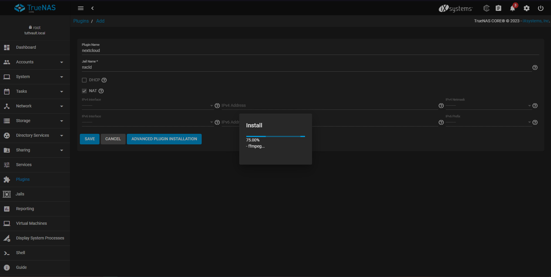

Hello!!
I've been using TrueNas for about 5 months and I am now trying to install nextcloud. Whenever I try to install it, it goes through the process and then gets stuck on 75% - ffmpeg. I left it for two hours to go to the gym and came back and it was still at 75% - ffmpeg. Wondering if anyone can help me!!! (I don't change any advanced settings when trying to install)
victort
Dec 31, 2021
973
Plugins are dead, and will go away in 2025.
They are not maintained.
Check my signature for a list of installation scripts (Nextcloud included) for Core or you could switch to Scale for a more point and click installation.

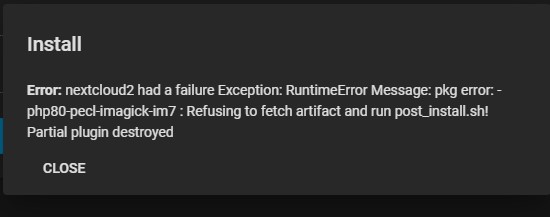

Similar issue here:
I am on TrueNas Core 13-U5.3 with PHP80.
My last Nextcloud upgrade failed and I reverted back to my previous working version (Release: 13.1-RELEASE-p8).
I am now trying to setup a fresh Nextcloud install but the installation fails (see attached error message).
It looks like it is again a PHP error as Nextcloud now expects PHP8.1.
Should I be installing PHP8.1 ? and in the case how ?
If plugins are no longer supported, I assume this will not get fixed anytime soon: Is this a ggod time to switch to Scale??

garm
Aug 19, 2017
1,556
Install in a jail.. script for semi automation can be found in resources. Plug-ins are dead
