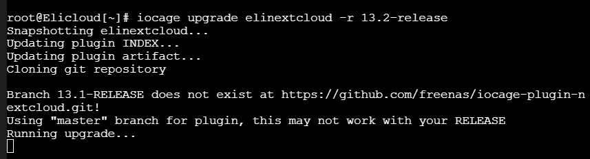

I tried to perform the upgrade from 13.1 to 13.2 with iocage upgrade -r 13.2-RELEASE nextcloud but the jail still is 13.1. Also tried iocage fetch (option 2) but doesn't work.

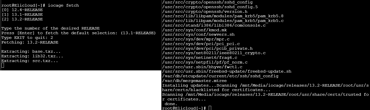

First, I have TrueNAS Core 13.0-U5.3. the output of iocage fetch looks fine (I think):

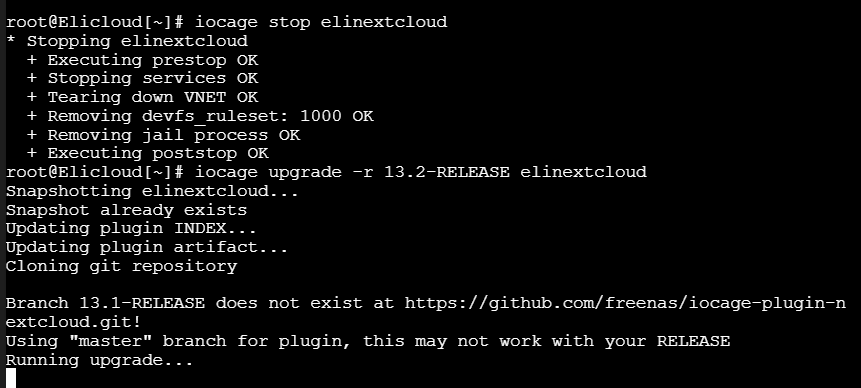

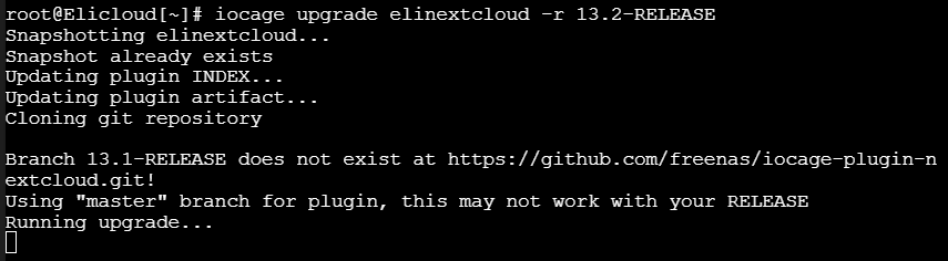

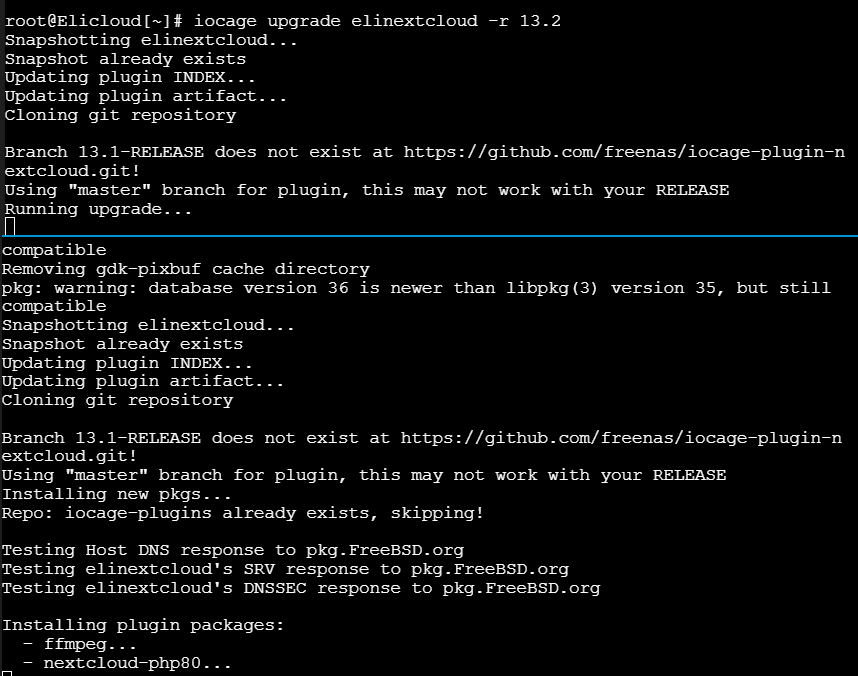

I built Nextcloud using Official plugin (I don't know if that has to do with my issue) and doesn't matter how I try, it doesn't want to update the Jail to version 13.2, is always taking 13.1.
I have tried every possible way and it doesn't take 13.2. I tried it with other Jails based on plugins and it's more of the same.
