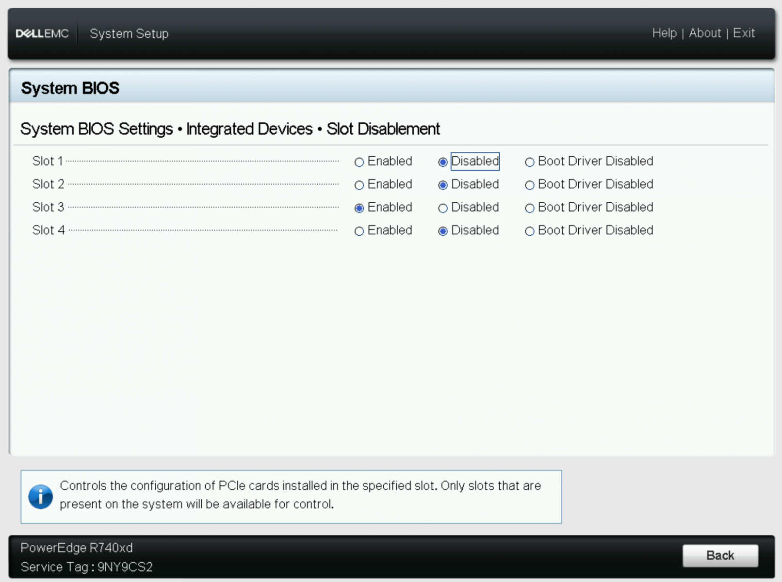

alright. so I've had some success. the server boots with the card installed now using these slot disablement settings, but it's not detected in Truenas.
Slot 3 is the Boss 1 RAID card for the OS
Installing the other card resulted in the same result, so it's not a card hardware issue. Pretty sure it's a BIOS configuration, but at this point I'm not sure what.

That's not super surprising, if the card is disabled it had better not stop the system from booting...
What's the deal and why does it refuse to boot? Good question, we're down to few options... Have you tried disabling the OpROM for the slot the card is in? Maybe that's what's causing trouble, even if it is pretty late in the boot process for such a problem.

I read it wrong, I thought disabled simply sets the card slot to ignore during boot.
In Dell BIOS System Bios > Miscellaneous > Load Legacy Video Option ROM is disabled.
This won't even boot when the slot is set to 'Boot Driver Disabled'

I wasn't able to find anything like it in BIOS, but you, my friend are a gentleman and a scholar. it's rare indeed to see an export of your level be patient for so long with a vague issue and not resorting to ridicule or superiority chest puffing.
based on this post I disabled the onboard NIC in BIOS, set the PCI slot to "Boot Driver Disabled' and Bob's your uncle.
