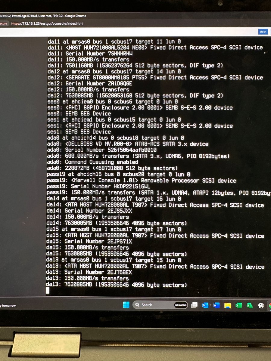

well, no joy.
I updated all the firmware in iDrac, the NIC, the backplane, BIOS and I still can't get the system to boot with the Intel card in it.
In iDrac the card shows connectivity when it's plugged into the network, so it doesn't seem like a hardware issue. I think it's inside of Freenas that the issue lies.
It was a bit of a long-shot, but it should be working... Have you tried other OSes?
