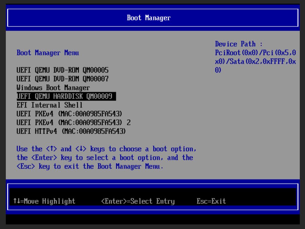

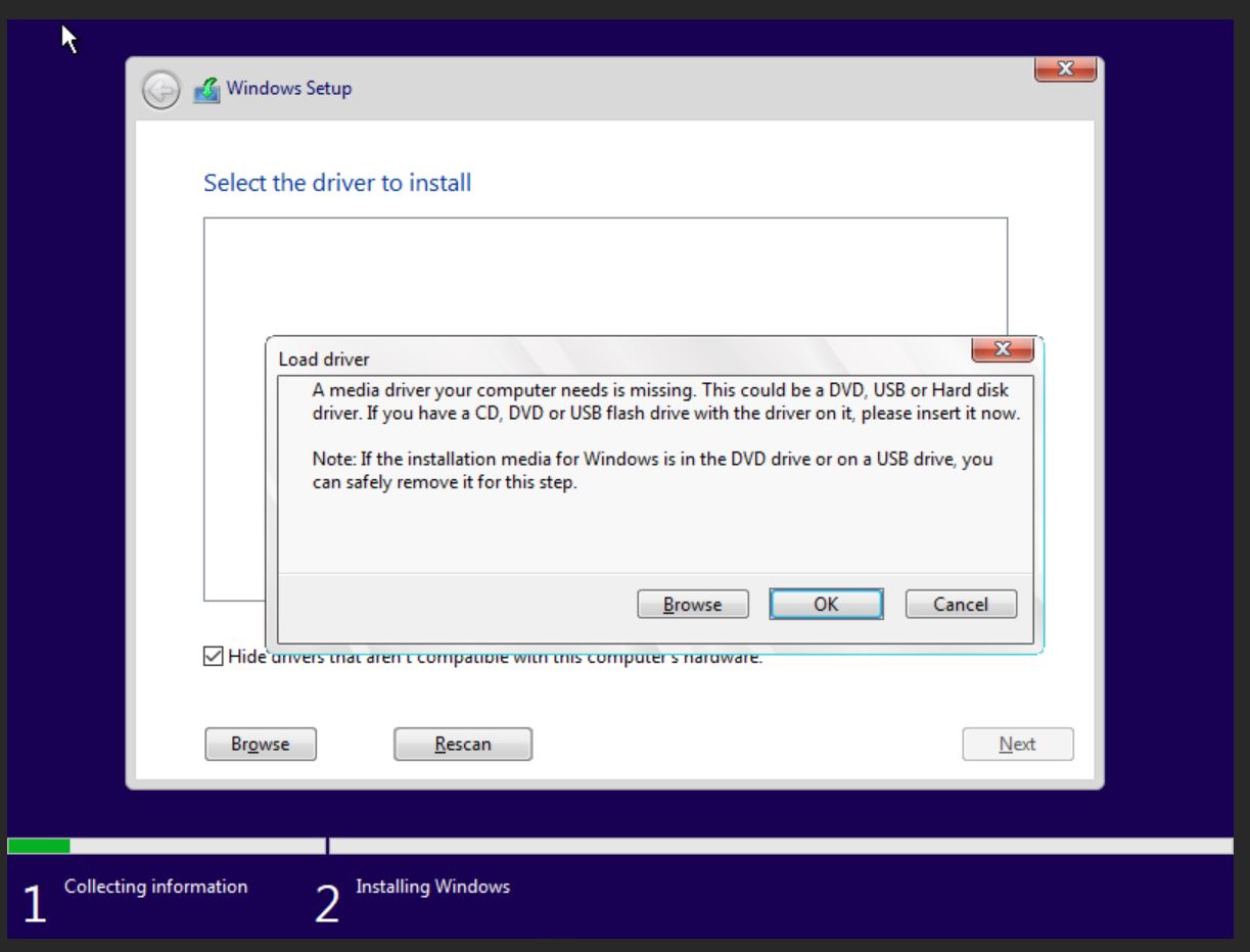

Working through installing Win10 on a VM, however when it comes to the point of selecting the install destination Windows Installer can never find the virtual HDD setup for the VM. The tutorials / videos i've found seem to have it just show up, Windows 11 and linux will find the HDD in the same configuration. In the BIOS of the VM the HDD shows up
Config:
Virtual CPUs: 1​
Cores: 2​
Threads: 4​
Memory Size: 8.00 GiB​
Boot Loader Type: UEFI​
System Clock: LOCAL​
Devices:​
DISK:
Mode: AHCI
Disk sector size: Default
CDROM: Windows10 iso
CDROM: virtio-win iso

I think this would still apply...
I think the bit you're stuck at is about 5:22 in the video.
el1milka
Feb 20, 2022
6
So, the driver I was looking for was inside the viostor dir, not in the vioscsi :). (virtio-win-0.1.217.iso).
9,700
Maybe something to be aware of is that versions above 187 have seen many reports of issues (you seem to have 217 there).
