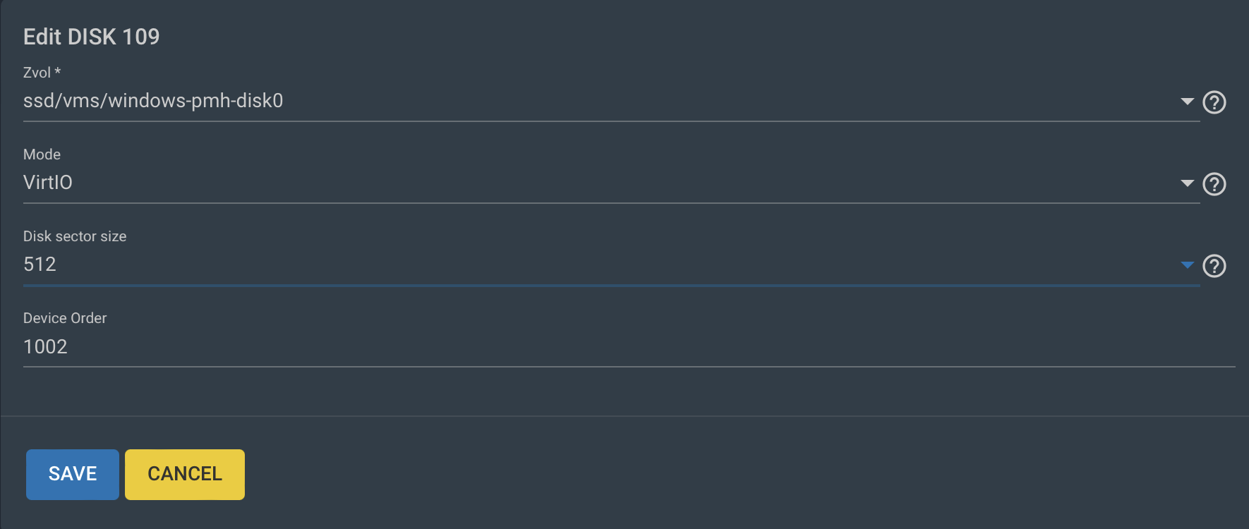

Change the blocksize of the emulated disk device from "default" to "512". VM > Devices > Disk > Edit.
Use virtio drivers for disk and network.

Hi Patrick, thanks for the quick answer. I did but same thing happened. I am using this virtio-win-0.1.208 driver. i load the driver and the install crashes.
Patrick M. Hausen
Nov 25, 2013
7,776
Try AHCI, but make sure to set the virtual disk blocksize. This alone has fixed all crashes with Windows 10 for me. 1636316857718.png
