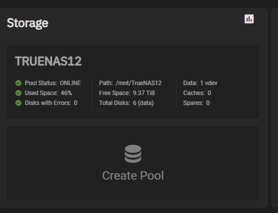

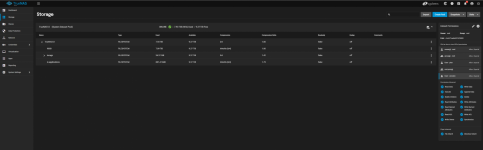

IMG 1 shows the storage Online, 6 drives no errors.

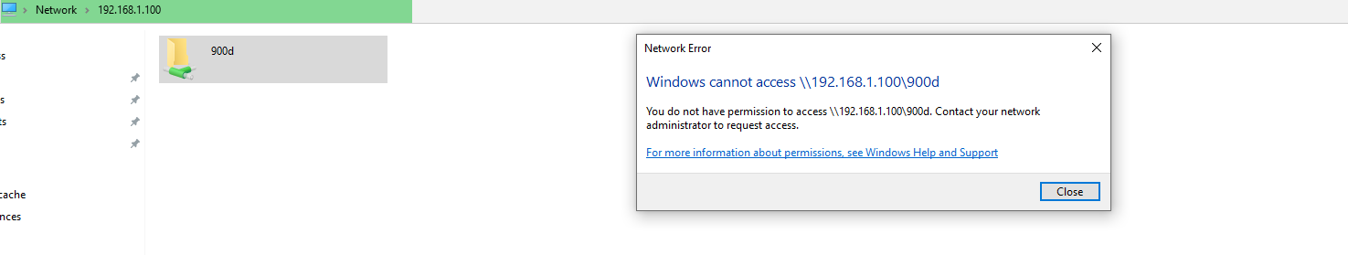

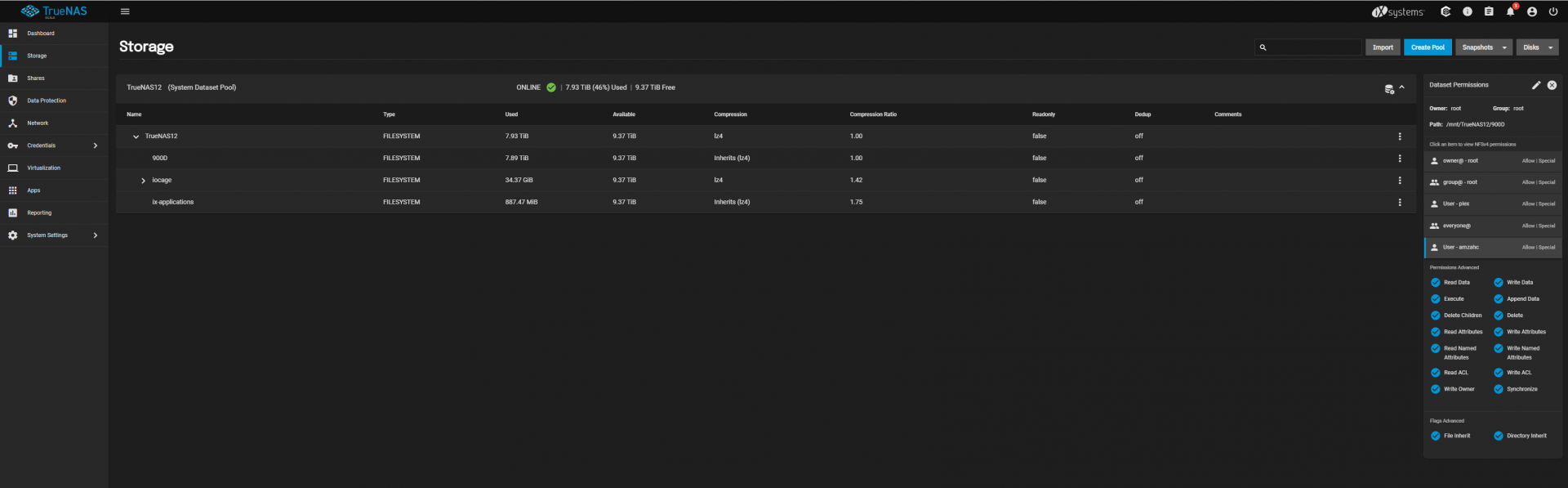

IMG 2 shows storage tab> pool online> - with dataset permissions for user amzahc - (as far as i can tell, all permissions are set; therefore the user should have carte blanche)

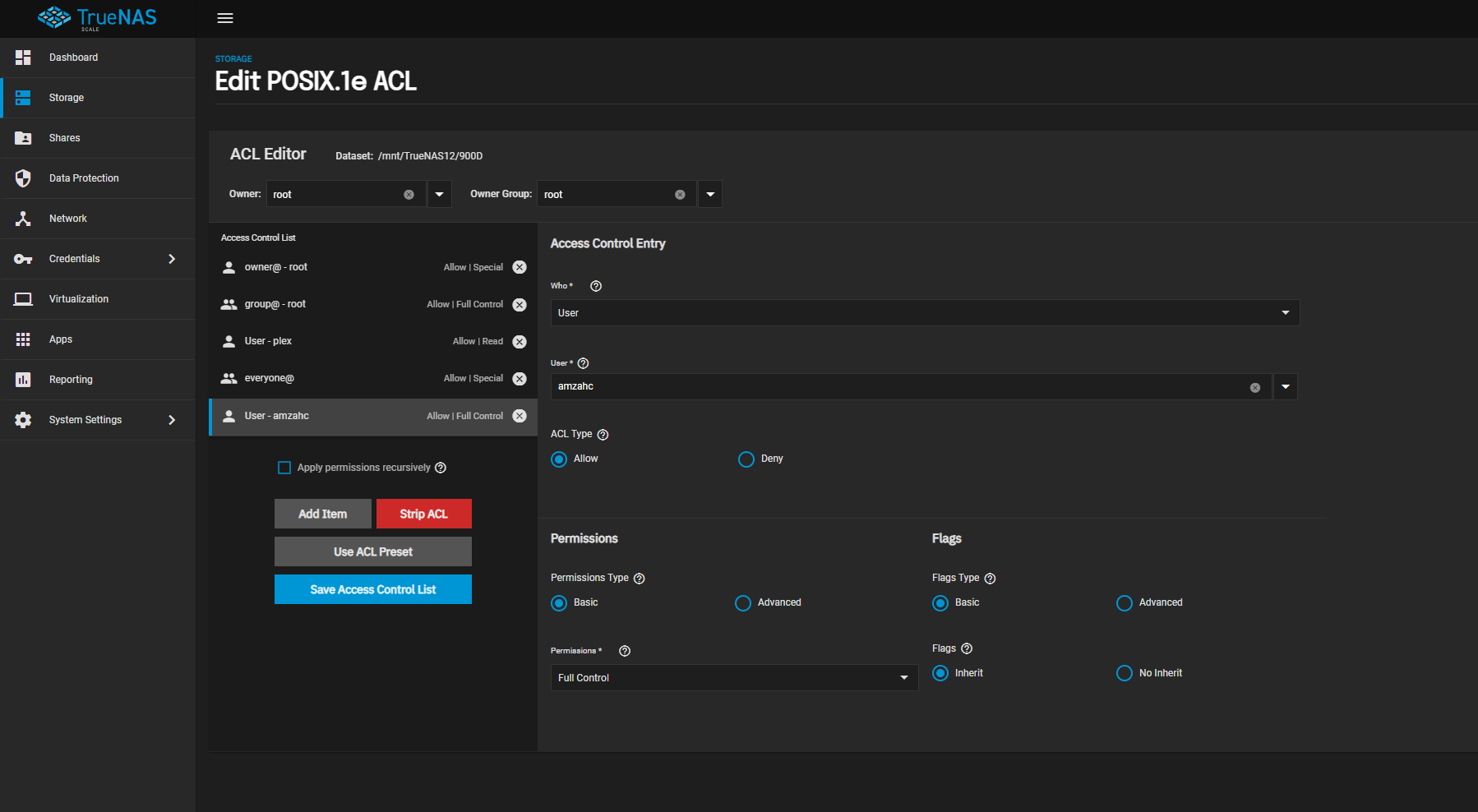

IMG 3 shows sharing tab>Windows SMB Share>Edit Filesystem ACL> (can confirm amzahc has "allow |full control)

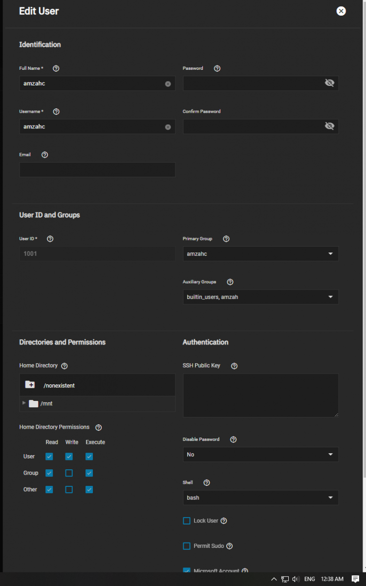

IMG 4 shows Credentials Tab>Local users>amzahc>(read write & Execute home directory permissions - not shown in IMG but can confirm Samba Authentication is
active)

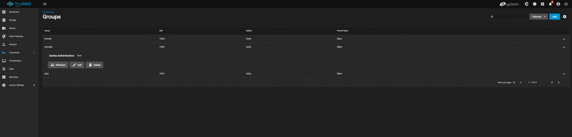

IMG 5 shows Credentials Tab>Local Groups>amzahc (user group amzahc. Samba authentication : true)
IMG 6 > run command on windows 10> Direct IP Addy of NAS > ' you do not have permission to access........"

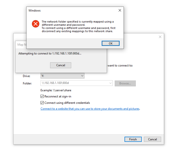

IMG 7 > Attempt to map network Drive > sign in using different credentials(both amzahc & root)> 'network folder specifed is currently mapped using different username and password. > Can confirm there arnt any other drives mapped.

Update - Remedy;
Further tinkering has resolved the error.

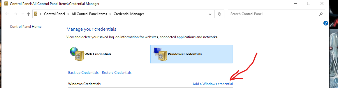

IMG 1 Within Windows, - Start>credential Manager>Windows Credentials>Add Windows Credential>NAS Address Username & Password
IMG 2 Within Windows -
Cowagz
Sep 1, 2019
5

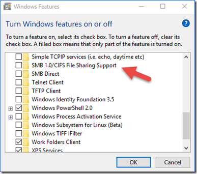

IMG 2 - Within Windows>Windows Features> SMB 1.0 and SMB Direct> Install.
For Anyone who is experiencing errors when migrating from Core to Scale(SMB Sharing); the above fix has resolved my particular error.
