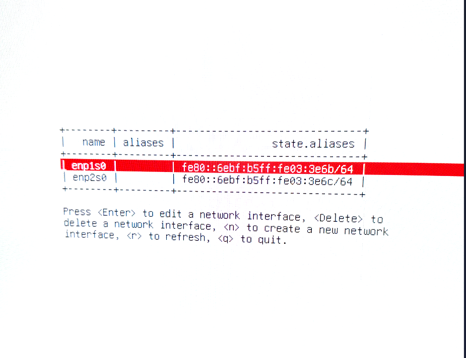

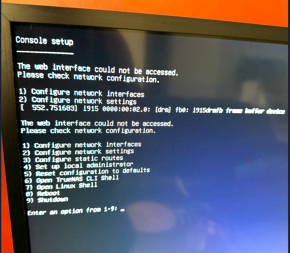

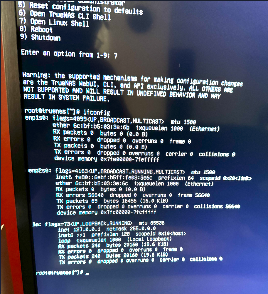

When i connect the NAS to a monitor i get the message "the web interface could not be accessed". I used the command ifconfig (pic attached) to find the MAC address of the NAS Server so I could see which IP address it has been assigned. For some reason there are two mac addresses, one under enp1s0 and one under enp2s0 (pic atatched). I assume that the second is used as a bridge for use with PLEX? However, after scanning using advanced IP scanner, i cannot see a device on the network at all which matches either MAC address.

Are you using ipv6 internally? Don't see an ipv4 here. Not bad, just an observation.
Edit one network interface and assign a static IP that is free. Make sure thats the one you attached your cable to.
This will give you access for now.
Take the device that is now using your desired IP offline (or release the IP by other means) and try to change the IP to that in your truenas GUI. It will allow you to test the setting before making it permanently.
You could skip the step of using another free IP first but I assume it will be easier to troubleshoot from the GUI for you.
A network bridge will show up as brX and then a number. I guess you just have two Ethernet ports on your server.
You have two physical interfaces, which will naturally have separate MAC addresses. Neither of those is a bridge, and I have no idea why you'd assume this to be the case.
As Chuck said, edit one interface (I'd suggest enp2s0, since that appears to be the one that's plugged in) to have a static IP address and go from there.
