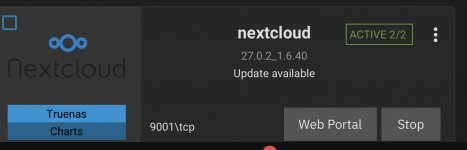

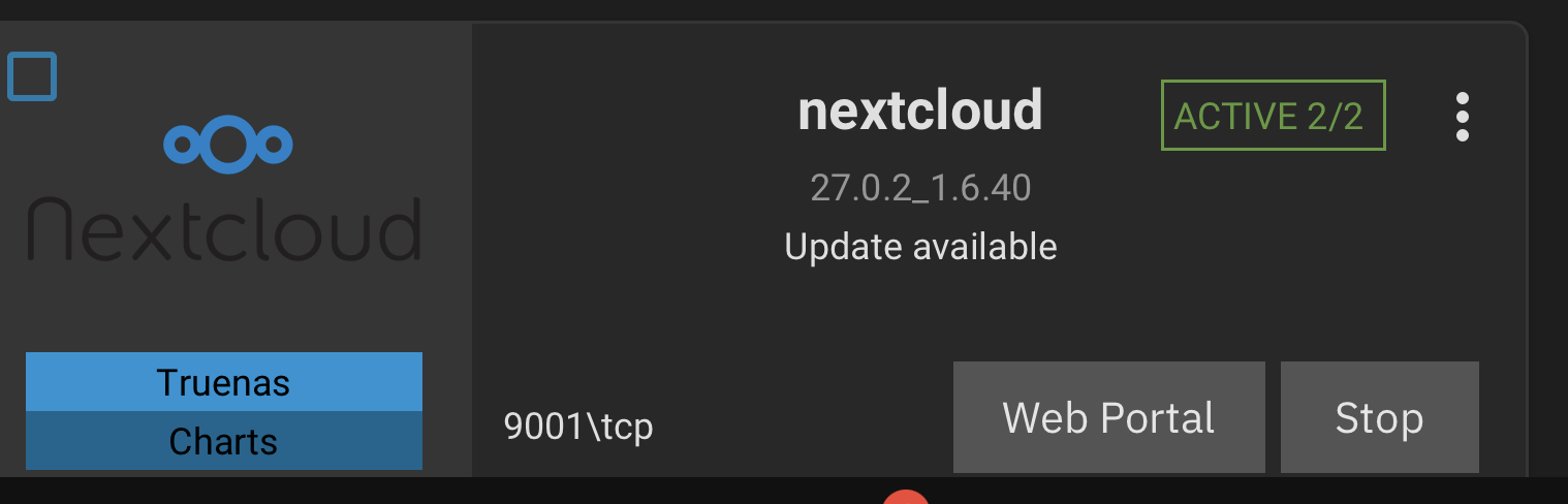

OK, that's helpful to know, but what I was trying to find out was what version of the Nextcloud App are you running? The TrueCharts or the "official" one?
Opps, sorry about that, here is a screenshot of my nextcloud
9,700
See my post above.
