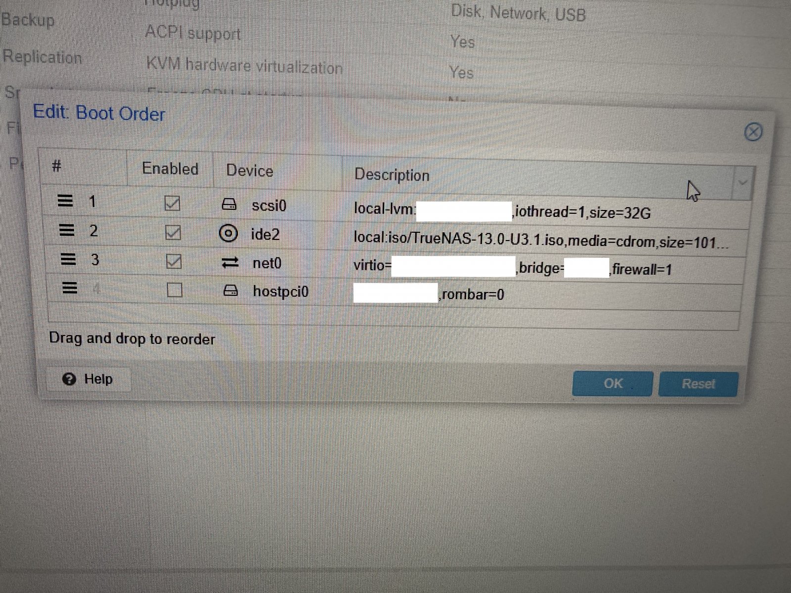

Set the boot ordering for the VM correctly. Just like your host system, the VM has its own expectation of where to find boot sources; if you fail to set this up correctly, it may simply be trying to boot FROM the HBA, which is an entirely reasonable thing to do, since the HBA may appear to be a preferential source over a mere SATA HDD or whatever you've defined the VM's virtual boot disk to be in Proxmox.
Also note that Proxmox only has experimental support for PCIe passthru, and you're attempting this on what appears to be a gaming board. There's no real reason to expect this to magically work out of the box.

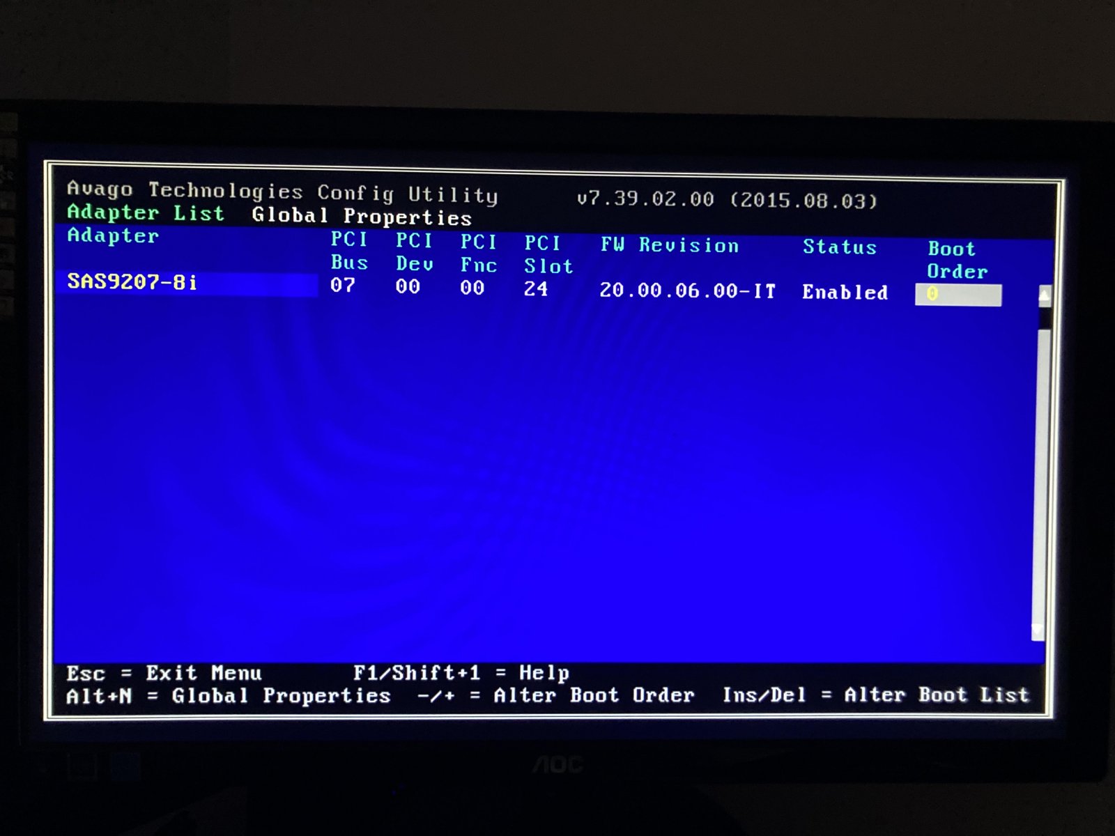

Just thinking out loud here but could this have to do with my card booting in the bios? If so how would I turn that off?
I see your point and 100% valid.
I did ensure the drive that held the system was set for #1 in the boot order, I even tried to disable to hba to boot in the startup. This did not effect any change unfortunatly.

The image included above shows the LSI's boot order as zero, which I would think offhand would be highest priority.

jgreco - you are the .......ummmm......grinch? !!!! aaaa helll, you rock!!! So it was the LSI booting ahead of the drive and hanging everything. As you can see the main drive is first, then the iso for install, then random proxmox stuffs, then the hba that is deselected. This changed nothing for me.

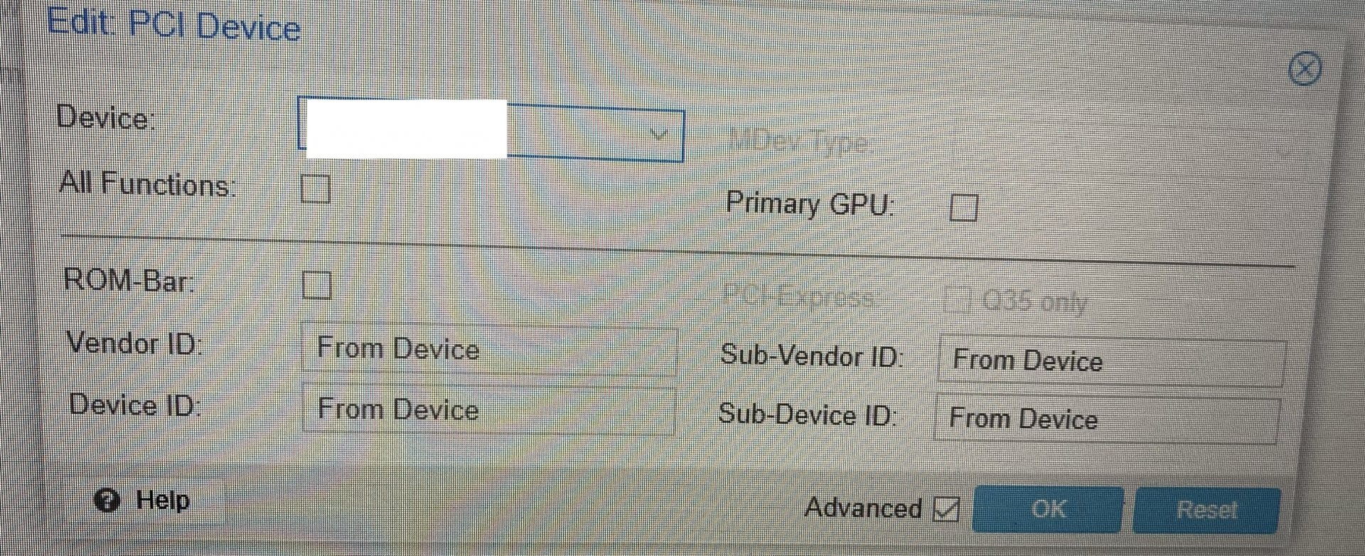

The ticket was editing my PCI device, deselecting all functions and rom bar. I tried one and then the other and for shear giggles I tried both and it went through. I don't understand it, I really don't but it works!!!!

I have re attempted this with 22.12 and it is working as well :smile: so some weird thing my HBA card picked up since before I had to use all functions and rom-bar as selected......Talk about a complete turn around :eek::oops::confused:o_O lolz
