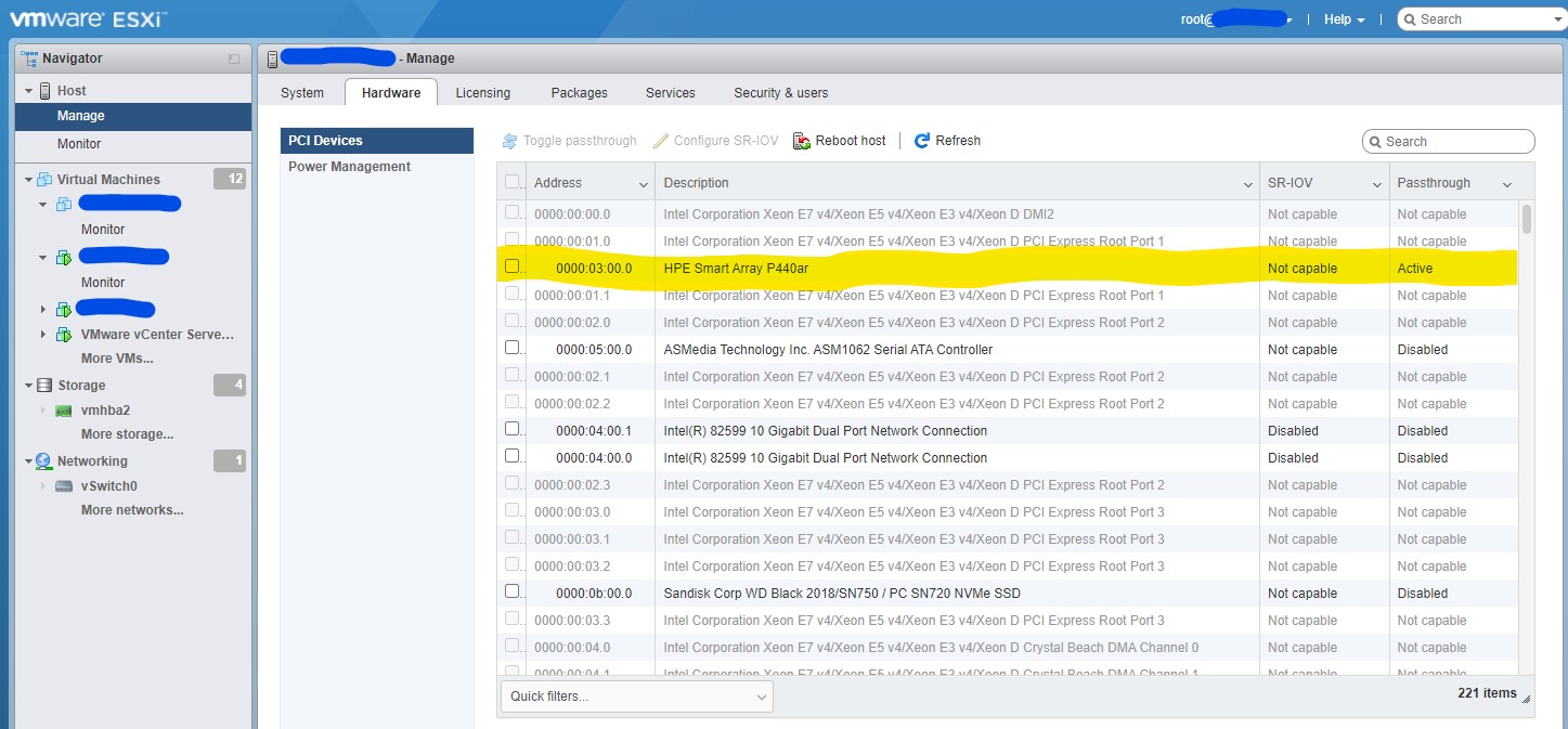

as @sretalla stated you need to pass the entire HBA device not just the disks. which means any disk that is on the HBA controller can not be used for any other function except to be passed to the TNS VM.
I had the same thing using VMWare. If you create each disk as a raid 0 or if you leave the controller in ACHI mood and only pass the raw disk to the VM of TNS then you get a disk serial duplication issue.
I circumvented this by booting VMware from a 250GB NVMe PCI drive and using the rest as a datastore. Then I created a VM for TNS on that NVMe datastore and passed the entire RAID controller using the passthrough function and gave the VM the PCI RAID device that was set to HBA. Once in TNS I created NFS and iSCSI folders and pass those back to VMware to use as storage. since it is all on the same physical server there is no lag on accessing the drives.

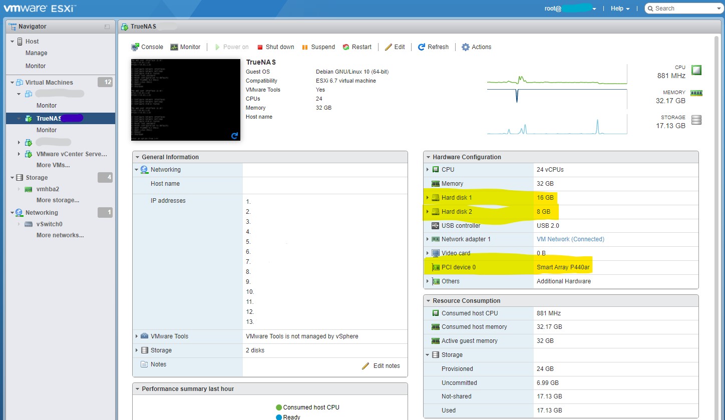

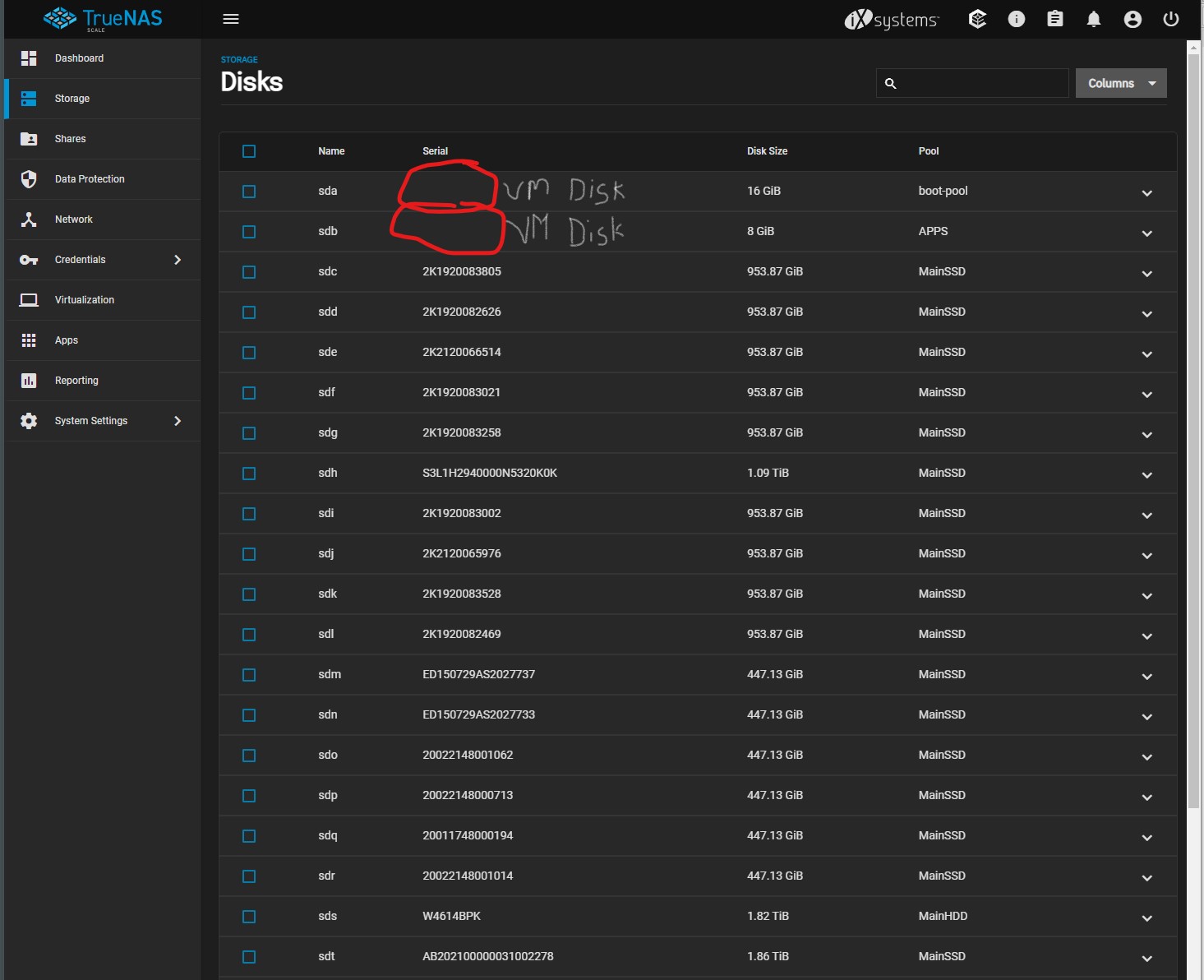

Thought pictures would help.
DL380 G9 24SFF with 20 SSD and 4 HDD ((10)1TB SSD (6) 480GB SSD (4) 2TB SSD (4) 2TB HDD) and 1 NVMe PCI Drive.
(2) E5-2680v4 Xeon
128GB RAM
This is my main VM server
did the same thing with another DL380 G9 12LFF Drives. This one is a media and backup server so less RAM and much larger Drives
(2) E5-2660v3 Xeon
64GB RAM
I HA the VMware installation and TNS VM amongst 3 nodes so I have replications of the configs, so if a server goes down I can be back up with little effort.
The best thing about running TNS on VM is that you can add and subtract anything you need. second Network adaptor, extra drive from itself for temp data. The 8GB VMware drive that is mounted is from truenas via a NFS attached storage to put the APPS store data on, this keeps it neat on the TNS server and didn't have to add physical drives.
