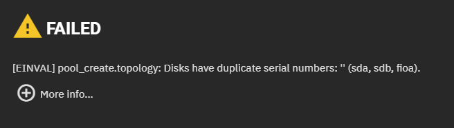

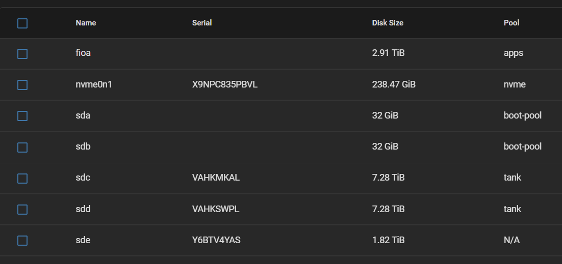

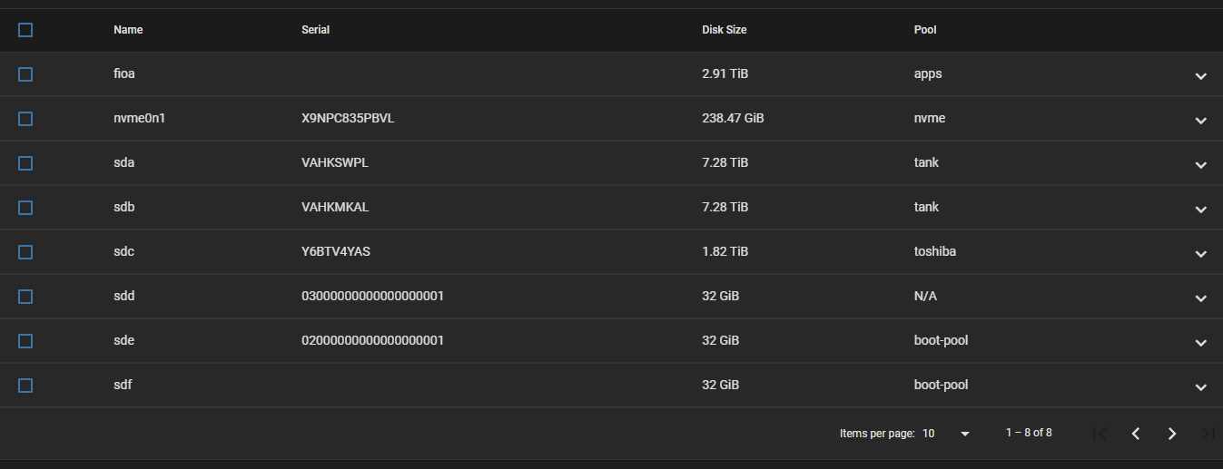

I'm having problem with creating new pool when i want to create new pool
sda, sdb are virtual mirrored boot drives for booting from ESXi
fioa is Fusion-IO card that doesn't pass SN to OS. I've moved everything from physical environment and it worked without any issue but now when i want to create new pool it refuses to to it. I know that there is no SN. That's not an issue for me. Is there way to put some random characters to gui to see or is there a way to make it to ignore it completely? I'm planning to redo main pool ( i have 3 now)

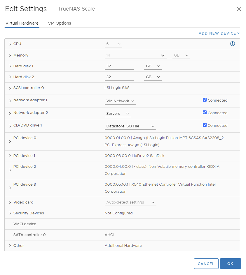

    i've read docs before and done that.
I've also used before FreeNAS with older ESXi maybe 6.5 and also i've used passed through 9211-8i HBA
Supermicro X9DRH-7TH and ESXi 7.03 with passed through NIC through SR-IOV, 2308-IT mode HBA, Fusion-IO 3.2TB Flash Storage, and regular Kioxia 256GB NVME
This wouln't be a problem if Fusion-IO would just pass Serial Number to OS. It doesn't. With Single Boot device there would be no SN issues. All drives are physically connected HBA.

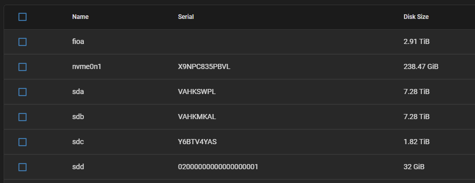

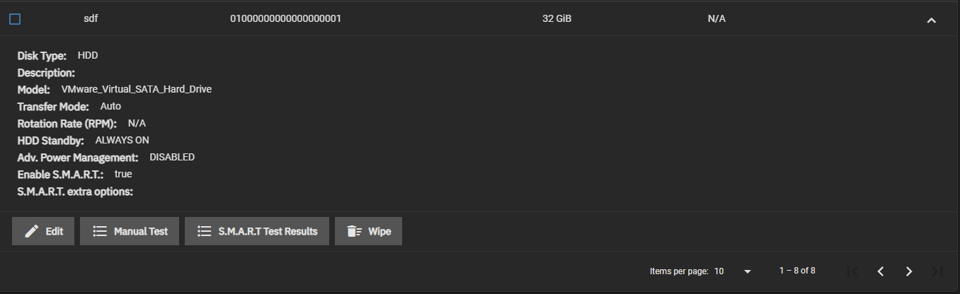

Hmm honestly i haven't trieed it yet. I did now
At first i used Vmware Paravirtualization - No SN
Then i've switched to LSI SAS on same drive - no SN
Now i've created completely new but i've connected it to SATA Controller - looks like some SN it there :D
In term of booting my 2308 doesn't have BIOS installed. I wanted to remove all overhead i could. It's LSI 2208 with 1gb cache converted to 2308-IT Mode using this instruction: https://mywiredhouse.net/blog/flashing-lsi-2208-firmware-use-hba/
Update
Unfortunately after switch to SATA It doesn't boot. I'll try to create backup of configuratyion and reinstall it on SATA drive. Maybe this will help
It boots only from single drive now. second boot-pool device with SN doesn't have grub.
Update2:
I was able to boot from SATA after all
Seems that i will be able to create pool from GUI without issues.

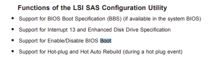

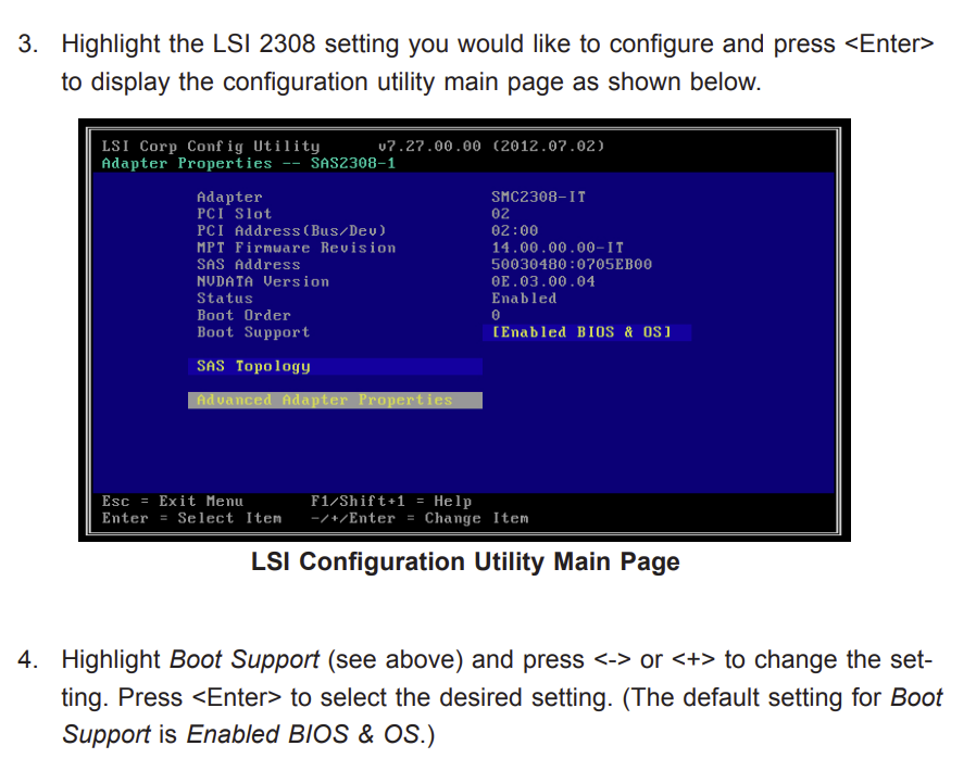

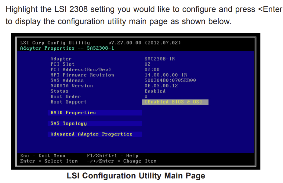

Have you enter Bios of 2308?
can't. there is no prompt to get there eg. "ctrl-C to enter configurator".
its like it doesn't have a bios.
I have a thread for it already, so if you have ideas, that's the better place for them.
